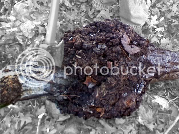

Now I have to figure out how to drag it out of the woods...
Heh, it's wild cherry burl (or Black Knot, or gall, whatever you want to call it).
I would cut it shorter but the other one I had checked pretty badly because I didn't seal the ends. I'm hoping to get this thing cut and soaking in DNA before too long...
I'm hoping a tarp and two of us pulling will help. It's laying in the woods a few hundred yards deep. Not that big, but it's heavy and darn awkward to hold onto.
Know anyone with a four wheeler and a chain???
Does the dna help pull the moisture out without checking and cracking? I would have thought it would pull it too fast...
Really cool, Skye. I bought one years ago, it cracked up pretty good, but there's 50 pen blanks in it still. But you're not kidding, mine was 2/3rd's the size of yours, and it still weighs a ton. Awfully dense wood, that wild cherry burl. It's also one of my favorites for bowl turning.

Yeah, I have no idea why it works but it seems to. I soaked a lot of green oak blanks with some nice lace in them, none of it checked a bit.

You can let them soak for 24-48 hours. I don't think there's a science to the timing. The oak ones I soaked were in there for 24 hours. I stacked them like a log cabin (I'm sure there's a proper name for it) to let them dry. Looking back, I should probably wrapped them in paper, but they seemed to do fine.

How does the DNA work?
The DNA "soaks" into the wood, and displaces the water in the wood. When the water is displaced in the wood, and the wood is taken out of the DNA, the DNA evaporates. This helps the wood dry and not check and crack. Bowl turners buy the DNA in 5 gallon sizes and soak blanks in big buckets, decreasing the drying time for the blanks. We turners are an impatient lot!
