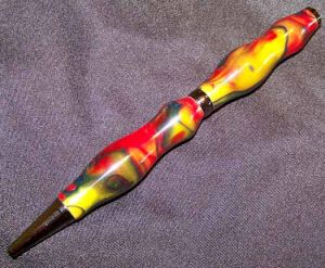

Gerry has it right though. Different colors will give you different looks. If you do black and yellow you can end up with green since the black is more solid and will show through the transparant yellow. It does work though if you can get the mixtures perfect. I've only been able to do that 1 time though, but here are the results:

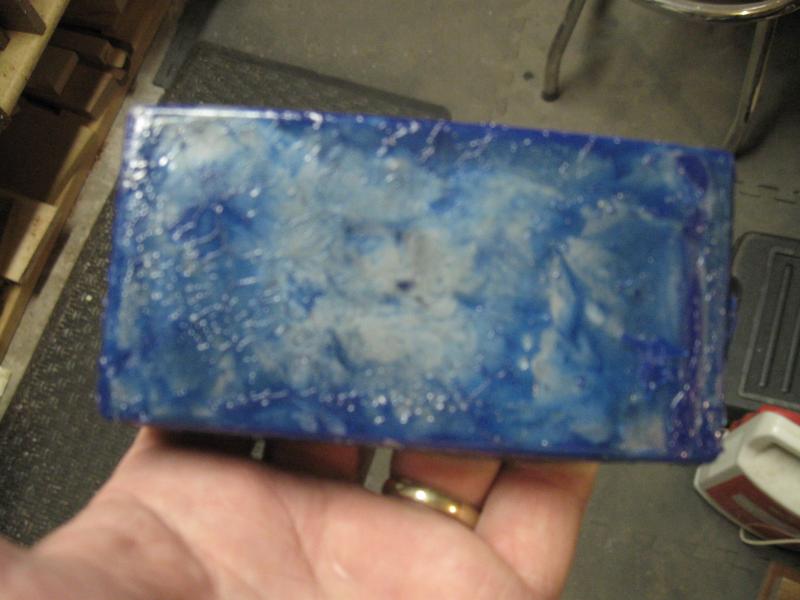

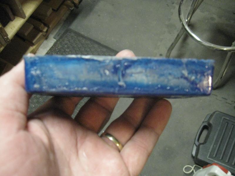

I made a small block of blue and silver yesterday, cut it and have not turned it but will post if it was worth it. Don't think I will be using the paints next time, like you all said expensive way to color the paint. Thanks for all the replies.

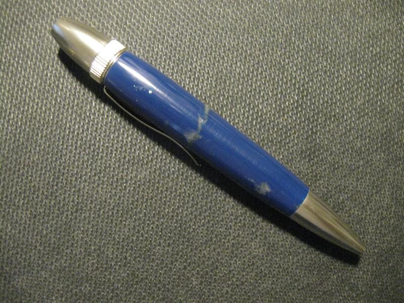

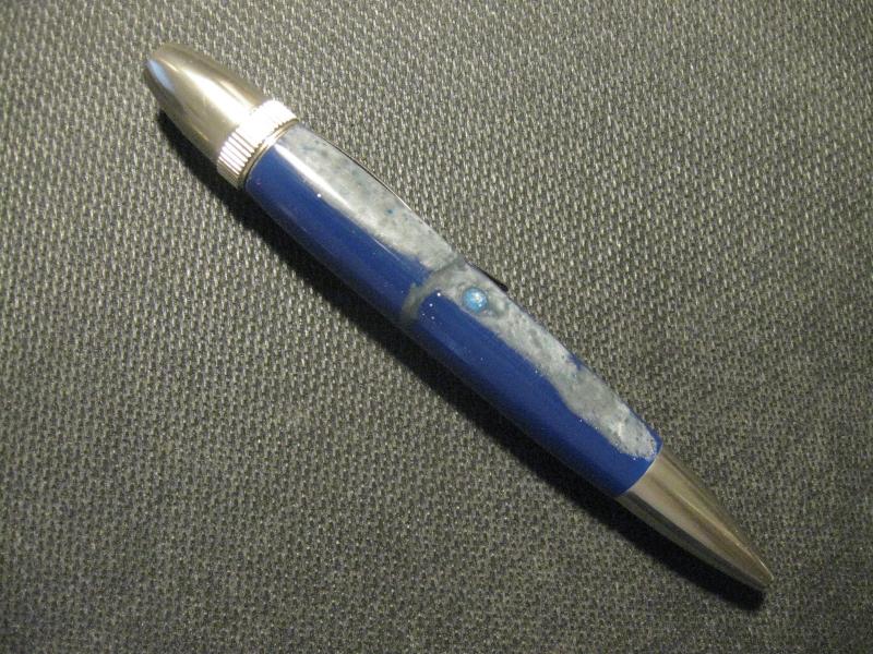

Here is what I got from my first try not bad but learned from it so that is a good thing.
