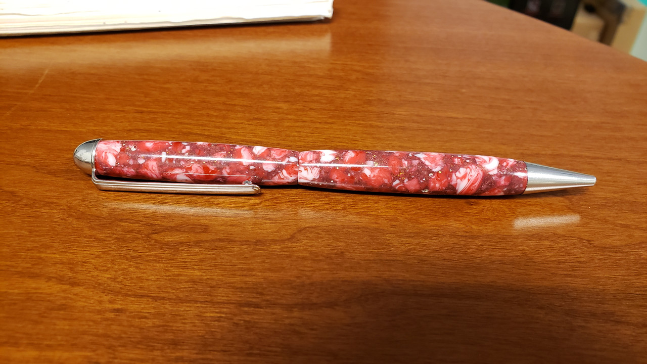

Hi all, been searching the casting forum and resources sections but all I keep coming up with are people asking for techniques and here I am starting another thread asking for techniques. Below was a first go at it and it turned out alright but I'd really like thinner, more defined webbing patterns. I saw an example of a pattern I really love in the featured pens section - first post by Carl Pepka. The purple and white is a great example of the definition I am looking for and the cap of his other pen is fantastic as well. It looks like someone smushed differnt color boba balls in a tube.

Forgive the terrible pen, it was an old 7mm is had in a bag and I grabbed the tubes and turned as if it were a slimline only to realize it was a European after I dumped out the rest of the bag. Oh well..

Thanks, Hokie. Interestingly that's kinda what I did for the above blank. It is Castin Craft polyester resin, 3 different colors. I did an opaque red and an opaque white that I intended to be the base, the larger pieces, then a translucent red-blue mix with a dot of opaque white to mute the depth and a dash of gold glitter just because, as the webbing part. Each component was 1oz
Catalyzed the red and the white and swirled them then let them sit till they got to a medium gel state. Chopped them up with a razor knife then catalyzed the "webbing" part, dumped it in and stirred the while thing up and let it do its thing.
My thoughts after turning this were more of the base colors, less of the webbing color. After the webbing color was added let it sit till it gets to soupy gel stage and then press from the top to squeeze some of it out and make the webbing finer.

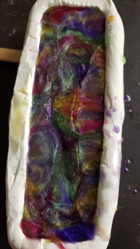

Anyway, unrelated to stone look but something I threw together tonight, hoping for a stained glass vibe

Followup to the unrelated post above. If stream of consciousness threads are frowned on here let me know,.

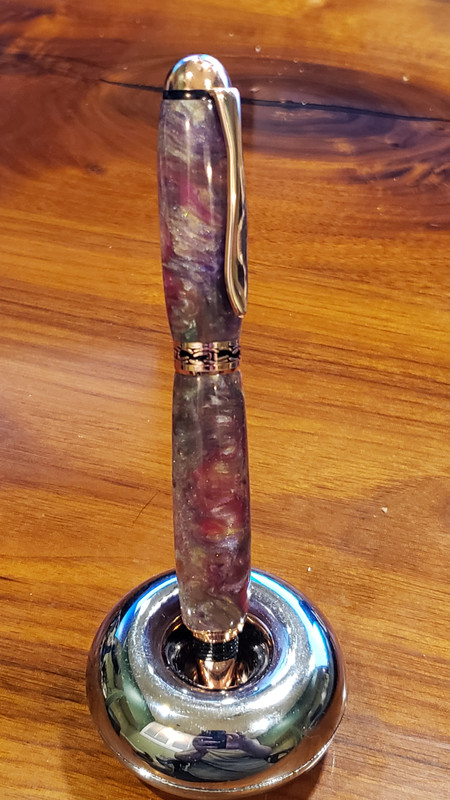

Well, that was a fail. I cast it in my shop without heat (64F ambient) and it had way too much time for the colors to bleed in to each other. Not one to waste stuff I had an old Sedona Copper on coolibah that the finish had clouded on so I popped it apart and put it on the result. I don't hate it but it's not what I hoped for.
