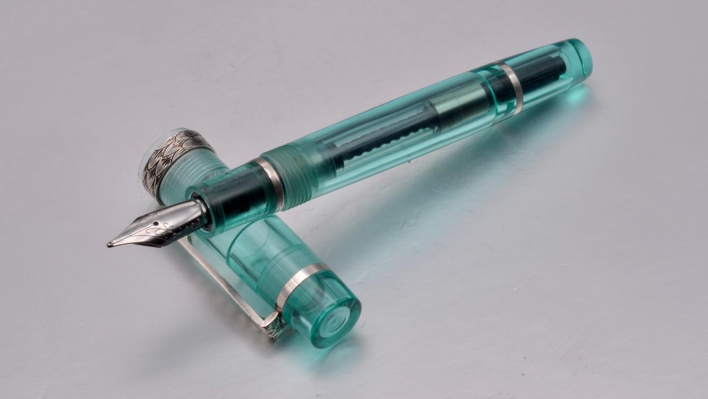

I recently bought a house, and spent the last couple weeks moving, which unfortunately cut my shop time down, so I've been working on this pen for a while, off and on. I made it from transparent teal acrylic, with Argentium silver trim. One of my friends dubbed it the "mermaid pen," due to the scale motif and ocean-ey color. It's about 5.25" long, capped, and uses a jowo 6 nib.

I always enjoy looking at your pens John.
May I ask about the flat bottomed holes? Most people have the 118º point from the drill bit at the bottom of their holes. You have a nice flat bottom (not you, your pen) in the cap and barrel. Are you using a boring bar with a radiused tip or some other tooling?

Good eye! I use a reamer in the barrel to flatten out the hole, and I use a boring bar inside the cap finial to make that hole flat bottomed.
