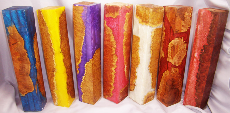

Ok not for pens, nor really Worthless Wood, actually burl caps sliced up with the cut faces placed outwards and the natural edge cast into Pearlex coloured poly resins for pepper grinder blanks. They take 0.8-1.2 ltr of resin and most of a small burl cap, so the ratio of timber to resin will vary, and weigh 2.4-2.6kgs. I've sanded the casts roughly to 65mm square by 350mm long, then coated them with Gelcoat poly to bring out the colour and seal them.
From left to right:
  • Red Coolabah with blue
  • Brown Mallee with yellow
  • Brown mallee with purple
  • Red Mallee with pink
  • Brown Mallee with white
  • Red Coolabah with maroon
  • Jarrah with red

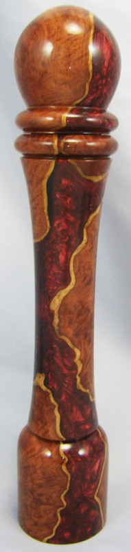

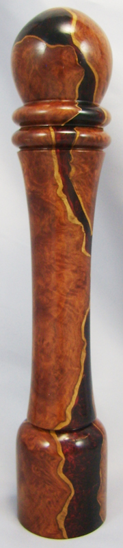

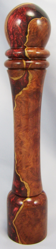

I couldn't resist turning one, so here is a Tas Myrtle burl with a mix of blood red dyed resin and Red-russett (maroon) Pearlex resin
. Not for the faint hearted or inexperienced, you need very sharp drills and chisels, with a carefull approach to avoid chipping/tearing the resin. It is finished with a few coats of Gelcoat Poly to help seal and hold it, then buffed with Hutt wax, and has a Crushgrind ceramic mill.

Those are stunning! I like how the line of different coloured sapwood defines the wood and resin boundary!!
Can I ask whats gelcoat poly? And us it waterproof?
Phil
Gelcoat is a polyurethane clear paint in a gel form to avoid dripping. Waterproof to a point like most paints.
