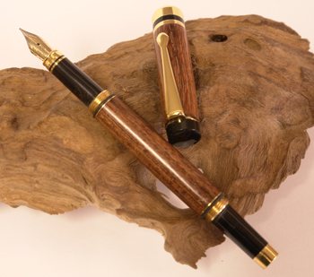

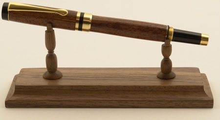

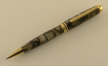

My Father-in-law owns a camera that I use a lot to take pictures of my turning products up up until now I have not had too much of a problem but when taking pictures of the pens is somewhat proving to be difficult as I am looking for quality the camera that I use is a Sony 10 million true pixel SLR camera the modal no is DSCR1 cyber shot' can anyone tell me what is the best settings to take close up shots with that crisp look
I have seem some pen images around the forum and wondered if I can archive the same the pen shot below was taken in a normal shoot mode (point and shoot).
Any help would be great.
Regards Mervyn
www.turnedwood.co.uk
What is the actual color of the background? If it's actually white, the color balance is off. The pen is out of focus at the tip. Turn the pen parallel to the back of the camera and probably set the aperture(f-stop) to f/11 or maybe f/16, where most lenses are at their best, then adjust the shutter speed accordingly. Since this is an SLR, it doesn't have a dedicated macro mode and would require a macro lens for really close focusing, but it looks like this lens will focus close enough. You will probably have the best success in manual mode, setting both aperture and shutter speed yourself rather than letting the camera decide for you. Aperture priority(A) mode will also work as long as you can set an exposure compensation because the camera will most likely not choose the best exposure combination.
Hi Gerry thanks for the reply the background was white and it was taken on a A4 paper sheet and edited in photo-shop, I have a feeling that there is a macro mode on camera ( it's a flower symbol) if that means anything many thanks for the tips Gerry I will retake some shots.
Regards Mervyn
I finally found a complete set of specs for your camera, but only on Sony's UK site. The camera is not a true DSLR, at least according to the specs, because you can't change the lens. It does have a macro mode and should focus to 35cm at the widest angle of view and 40cm at the telephoto end. What I can't tell from the specs is whether you can manually set the white balance, although maybe that's what "one push" means. Check your manual and see if you can set the white balance. If you can, follow the directions and set it that way for your lighting setup. Set the color reproduction mode to Adobe RGB, and make sure that sharpness, saturation and contrast are set to normal, these are better done in post processing if needed. Set the camera to Aperture priority and the metering mode to spot and set the aperture to F/8 or F/11. Then with only the white paper in place, press the shutter release half-way and see what the camera shows in the viewfinder for shutter speed, let's say it shows 1/60. Now switch the camera to Manual mode and change the shutter speed to 1/15 and leave the aperture where it was set. Now put your pen in place, focus and take the picture. BE SURE to use a tripod and don't use the flash. Don't do anything to the photo except resize it and post it here.

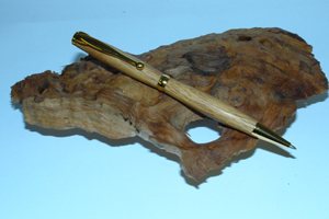

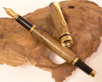

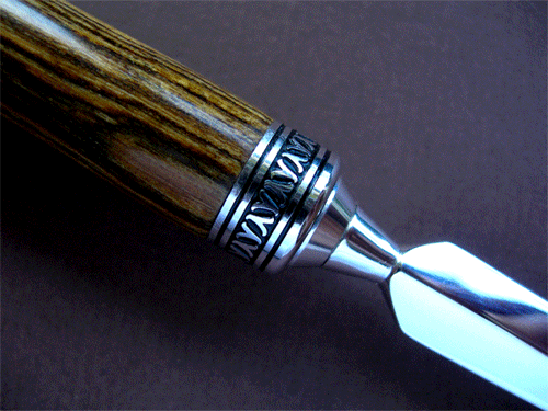

Hi Gerry I took this pictures before I read your posting but I will try them instructions you posted but anyway these are the settings I used to take these shots macro was on, ISO was 400, M-mode ( manual), shutter speed was 80 and F11 with auto flash seems to me that the shot is in focus but cannot get rid of the blue background this was all before I read your tutorial Gerry.
Thanks very much Gerry I know there are errors on these pics but it's and improvement than the last picture.
Kindest regards Mervyn

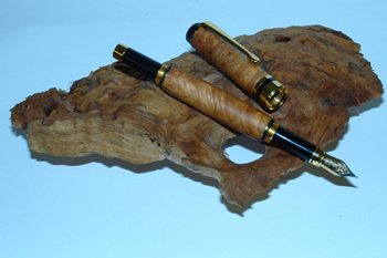

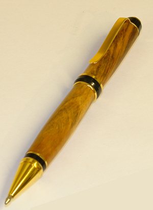

Hi again Gerry still got a few problems I played around with settings and took about 20 images of different pens all came out slightly different from each other so was hard to find out what I was doing wrong but here goes anyway I will try it again the weekend when I have more time
Regards Mervyn
These are both pretty good, but, if you can get about halfway between those two I think you'll have a better photo. Did you set the white balance? I'm really having trouble figuring out where that reddish color in the shadows is coming from, unless you have the white balance set for "auto."
Thanks Gerry I had to drop the exposure down a bit because they where too bright in the bottom left-hand corner of the picture just need to understand the settings a bit more as I am no photographer' I have got a few ideas that I'm going to try will keep y informed. Thanks Gerry

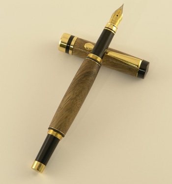

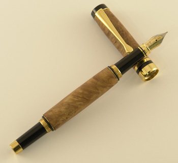

8.and everything else was normal ie contrast and so on, sorry my camera skills ar not good. Here is an update of some shots I took.
On camera these shots looked great until I put them on to the PC now my background is grayish' I wont post all the images but some are slightly lighter than other's.

I think you are just about there. However, I don't know of any camera that has a "spot" setting for white balance. You have to mean the metering or autofocus mode. White balance has to be things like sunny, cloudy, incandescent, etc. When you use a white background, the nature of light meters will make the white come out gray, so you need to know how to defeat that. There are two ways to defeat it. The easiest is to use exposure compensation, which your camera probably has. Set the exposure compensation for -1.5 and take a photo of the pen. Then set it for -2.0 and take another one. One of those will be just right.
And make sure the metering is set for multi-segment.

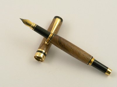

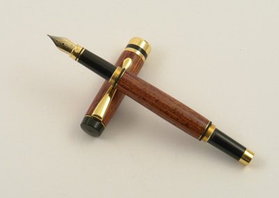

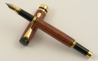

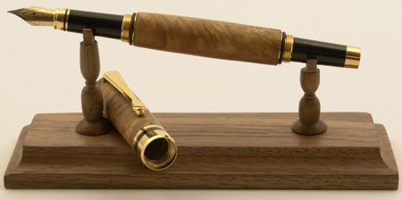

Hi again all, Ok hopefully I have cracked it, I raised the 150w lights up a bit to start off with, the camera settings were F-stop 16.0, exposure time 1/2 sec, exposure program-manual, ISO 400 white point 0.3.
The background has a slight off white but I'm happy with this but if you can seen any flaws in the shot and how I can improve in anyway please let me know, the only thing I want to do now is to make myself a a slim pen stand got a few ideas in mind will post an update later.
Best regards for your all help pen-turners.
I will take your comments on board as always.
Regards Mervyn
White balance is still off. The first photo was not a focus issue it was a camera movment. tripod and time shutter release fixes that. they are looking much better but color is still tented. The camera needs to know it is shooting under incondescent light, or this is the best it can do. Lighting is looking really good. I also like how you have things arranged in teh photos. two down dozens to go :)
