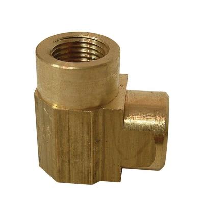

The pipe on my pot (from H.F.) was screwed in with thread sealant. It took a bit of effort but I was able to remove it. In it's place I screwed an elbow to keep incoming air from blowing directly onto the molds.

as far as the elbow mentioned ... is it something basic like this? that is a 90, should I look for a 45 to help airflow a little or does it even matter?
