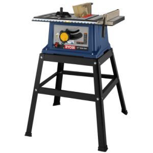

Ryobi 10 In. Table Saw W/ Transp Stand
Model BTS21

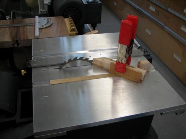

I have the saw AND the disc sander and would't trade them for anything! I do have a regular table saw for the larger stuff but this little saw will cut anything you throw at it and with PRECISION. I got the micrometer fence adjuster with it and can dial in the fence .001" at a time.
When I first got it I practiced making segmented blanks using 7/8" Curly Maple and Bloodwood and I had NO problems cutting right through it. The motor is powerful and it is built like a tank.

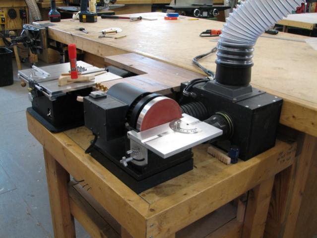

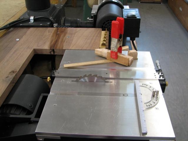

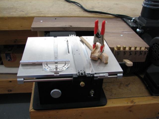

Here are some photos of how I set it up.......
I made a little box so I could connect both machines to my dust collection system with a quick connect.
This shows the micrometer for the fence.
Since the blade doesn't tilt I made this 45 degree jig. I can clamp a stop to it so I can get the repetitive cuts needed when making segmented blanks.

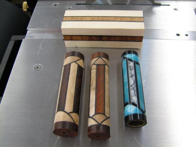

Here are some of the results I got. The two on the left are Curly Maple and Cocobolo with dyed wood veneer. The other one is all Tru-Stone with homebrew PR for the black.
I had no problems at all cutting the Tru-Stone.
I would recommend this saw in a heartbeat for small precision work like pen blanks. It is a joy to use.

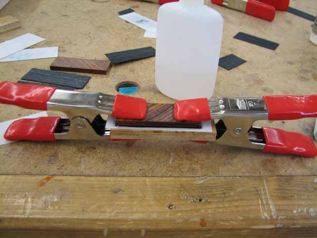

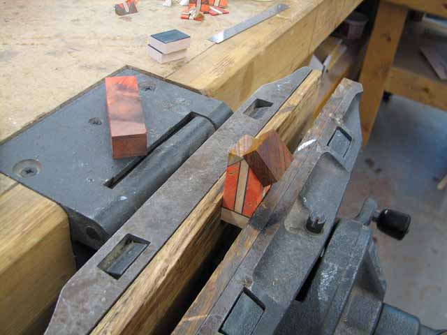

I'm going to attempt to create the segmented pens you showed - with the scalloped ends. Gorgeous pens, BTW. My only question is - do you use a glue-up jig of some sort? I was thinking of putting something together with UHMW pieces and toggle clamps. Man, I hate using CA glue! No matter how careful I am, it still gets on my fingers/gloves. (Of course, that's probably true of any glue I use!)

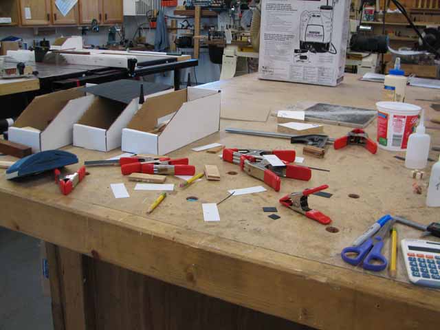

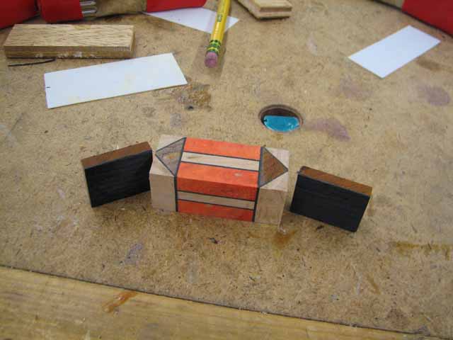

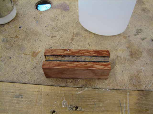

No jigs, here's a few photos......
