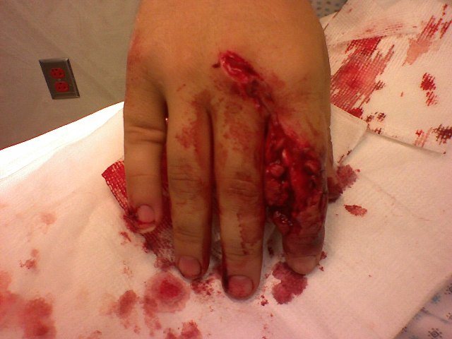

Table saws have to be one of the most dangerous tools in the shop. This is a picture of my co-workers hand after a kick-back caused him all kinds of damage. He was lucky to save his fingers, but he is in a cast for 6 weeks with tendon damage.
ALWAYS BE CAREFUL AROUND POWER EQUIPMENT AND USE PROPER GUARDS!!!
WARNING - THE PICTURE BELOW IS VERY GRAPHIC!
Ouch is an understatement. He's in for a lot of physiotherapy after the cast comes off. A very good reason why I have a lot of respect for power tools. I hope he makes a full recovery.

BTW....Why is the ground on the plug in the background on top instead on the bottom?

How much morphine did it take to get him to pose for the picture? How many pictures did you have to take to get the gore 10 factor?

It looks like he will make a full recovery, but it will take some time to get the mobility back in his fingers. His immediate days of guitar playing will be slowed down for a while, but he will get to play again.
Would you believe he took this picture of his hand with his phone by himself? Maybe there was enough morphine in him to not notice! The one thing I didn't mention was that the piece that kicked back almost broke his other arm? He was really lucky...except now he has a few new names at work like "Frodo".[:)]

Good luck on your co-workers recovery. His little finger is pretty well mangled for the rest of his days.

Did the damage come from the piece of wood kicking back or from the kickback causing him to hit the blade with his hand? It looks to me that the blade did the damage. If so, then yes, the SawStop would have prevented it.
Either way, a good drop in splitter with an overarm blade guard and push sticks will all but eliminate these types of problems.
that is why it is illegal to have a table saw unguarded in the uk. he is very one lucky guy. one question to all, how much would it cost to make a push stick. as an health and safety official i see this far too often. take care all. regards colin.
Last year I had an accident with my tablesaw but due to safety habits left over from my high school shop teacher, I still have my thumb and can use it. Here's a tip for you just in case you have one of these accidents; the white stringy looking stuff that can sometimes be hanging out of the wound, as it was with mine, are nerves. If my defense, I thought that it was just damaged skin. Don't pull it out to "clean up" the wound, as I did. My thumb healed with a descent looking scar but it still feels like I'm wearing a glove on it.
Whether the injury was caused by the blade or the kickback is unknown. It happened so fast that he can't remember and an accident investigation could not tell. In this case, the guard was removed because the pieces were higher than the guard and it interfered with cutting. To his defense, the material he was cutting was a special plastic. It ended up warping with heat as it cut through and clamped down on the blade. Of course, a push stick would have reduced or stopped any injury, and that was the recommendation of the investigating team. We are all jus thankful he still has his fingers and can use them.
