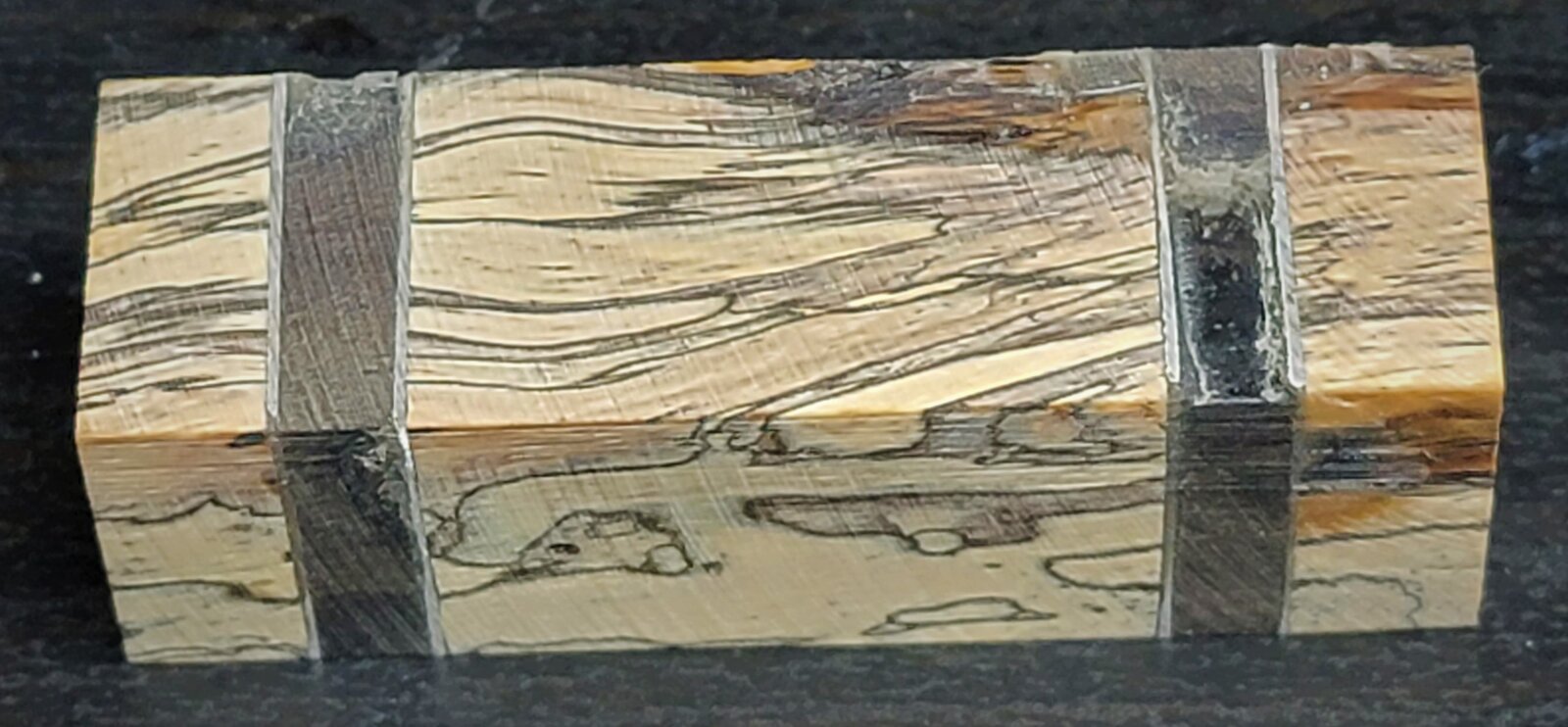

Brand new to segmenting and attempting my first go at it. I've done some digging and kept seeing T88 coming up as a preferred option so I picked some up then cut and set up my first segmented blank...and then read the package for cure time. Nothing. Ok, off to the website where after a bit of digging came up with...72 hours!
Patience, like most virtues, is not something that I possess in any great quantity.
Since this is my first shot I am not attempting anything particularly challenging; just a few simple bands of aluminum/ebony/aluminum.

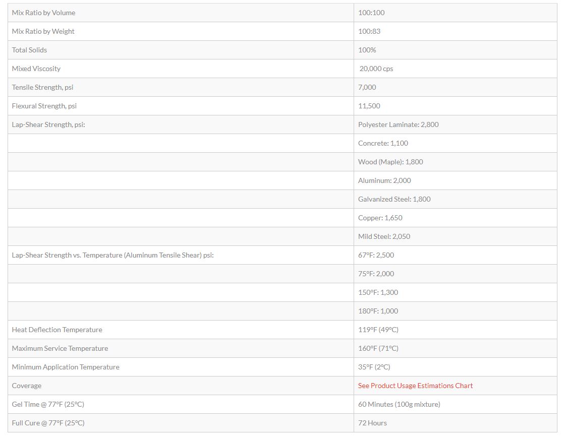

The cure time is temperature dependent. I also picked up T88 recently, due to some segmentation failures with the JB Weld and CA I had tried before. The T88 cure time in colder weather is days to a week (can cure as cold as 35 degrees). But under normal conditions, its much less time than that. Strait from the data sheet:
"At 70°F, T-88 will harden in 6-8 hours and will reach functional strength in 24 hours. T-88 has been specifically formulated to cure as low as 35°F without reduction in strength; this cure will require approximately one week. At 150°F, T-88 will set within 30 minutes and develop maximum bond strength and impact resistance after 2 hours. If excessive flow-out occurs, allow 2-4 hours at room temperature before heat cure."
So, at room temperature, its hard in 6-8 hours, full strength in a day.

Thank you @jrista for your reply. I have done quite a bit of laminating epoxy work so I am somewhat familiar with epoxy and have a heat-lamp setup for curing carbon fiber which I put my segmented blank under so it has been sitting at around ~100 degrees for 23 hours. The only information I could find on the cure time was from the S3 website under physical properties:
This is what I was basing my information off of.

My first blank, so far: spalted tamarind, aluminum, gaboon ebony.
Fingers crossed that it drills and turns ok!

It is nice looking blank for sure.
I let mine cure for 24 hours. I've never had a problem with pen vs. blank splitting or coming unglued. I also use a 50/50 ratio on the glue. A line of Part A with an equal line of Part B.
May I make a suggestion? When doing a simple segmented blank like that with only flat surfaces. It is better to drill the pieces before you build on the tube. Just be sure to use something to hold the metal pieces. I would drill the wood blank on the lathe using a pen chuck or some other chuck that can support the blank. Find center of the blank by making a cross from corner to opposite corner. Now use an awl and make an indent. Use a pointed live center in the tailstock and line the point with the indent and lock the headstock chuck down. Now replace the tailstock with a drill mandrel and use a starter bit and switch to the size bit needed for tube. Then cut the blank accurately to sizes needed and when build allow about 1/32" on each end for trueing ends later. Sounds harder that it really is. But it will save you angst when drill all in one. Just a suggestion. That is the way I do those type blanks.
This is the data sheet I was using:
http://simplexaero.com/wp-content/uploads/2011/02/T-88_TDS.pdf#:~:text=cure%20as%20low%20as%2035°F%20without%20reduction%20in,heat%20cure.%20BONDING%20WOOD%20WHITE%20OAK%20AND%20TEAK

Nice looking blank!! Gonna be a beauty!
I am still a beginner with this kind of segmenting myself...but, to what John T said, I have found that drilling any segmented blank with metal layers is fraught with trouble. That is always where my segments separate, at the metal to wood or metal to resin bonds.
Given how beautiful this blank is, I recommend adding some external structural support, to maximize the chances of success once you drill. What I did the last couple, was to glue on some of those fat popsicle/craft sticks on the outside, so that there was some additional support holding all the segments in place. I thought about wrapping that with something else, but I ended up just drilling with the craft stick outer layer only. It worked, and I was able to drill without anything separating. I've only done that twice now, though, and I have more experimenting to do. I think, also, that so far all of the blanks have been resins and metals, no wood yet...
One thing I have not yet figured out how to do though, is drill the metal layers on their own. I always seem to have some kind of problem trying that. So far, I've been trying to glue down or clamp down the pre-cut squares on their own. I've tried gluing them on the flat surface of a sacrificial piece of wood, and that really didn't work. I tried gluing and clamping, which was a bit better, but I seem to get a rim on the back side of the hole, which then requires extra work to work that out. Even when I drill real slow. I currently have mostly bradpoint bits, and I think that is part of my problem, so next time I get into segmenting, I intend to buy another set of drill bits that are not bradpoints, and see how that goes with the metals.
One thing I did see in a thread a while back, was someone drew out all the metal segments they wanted on each piece of metal, then drilled first, then finally cut up each piece. That, to me, seemed like a much better way to go about it, as you would then have a lot more metal surface area to clamp down or do whatever you needed to do to hold it in place properly while drilling. Still would need that sacrificial piece of wood, but, I think it would work better than what I had tried before.

I ended up trusting myself and used three new jobber bits to drill while it was clamped tight in a blank vice on my drill press. I made three passes with the drill press: small, medium, and final diameter. I went slowly and backed out often. As soon as I felt the aluminum I made sure to apply constant but light pressure and I am happy to say that it went without a hitch.
I will post a separate thread for the pen but I have to say that I am kind of surprised that I was able to make something that looks like this does.
Again, HUGE thanks to all who offered advice here. It all contributed to my first successful segmented pen!
