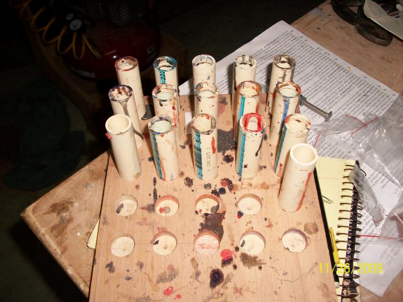

I use 3/4 cpvc for molds.
I like that PVC idea. I too would like to start casting some blanks. How difficult is it to get the hardened blank out of the PVC? I got the stuff from Micheals. I even bought some of their mold maker stuff, I mean crap, which didn't work.
I think it depends on the person. I personnally have had no luck getting them out. I cast under pressure though but don't think that causes any problems.
I haven't given up and you shouldn't let my experience stop you from trying. I just wanted to let you know it doesn't always work great....:mad:

Cut the pvc long wise and tape back together with masking tape. The blanks will come out easier when you remove the tape...
