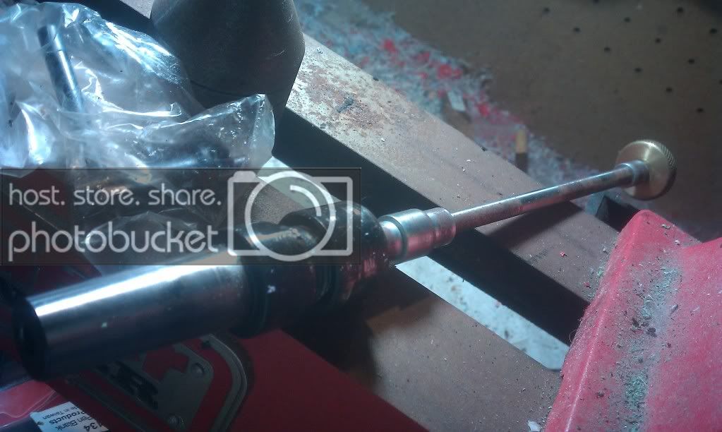

So I took off the tailstock, installed the drill chuck, and tightened in the appropriate bit.

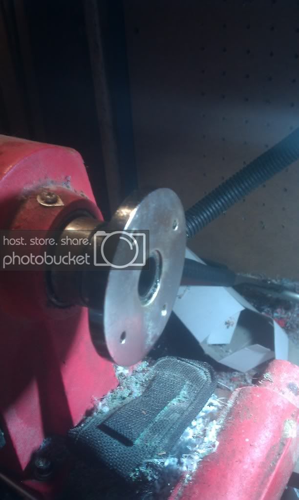

Next I took the mandrel out of the deal that's on there...my problem is, I can't get the face plate that is screwed onto the headstock threads to come off...locking the spindle doesn't do anything but start to chew up the gear in the inside. Any thoughts? I've included some pics...
Face Plate:
Mandrel, removed:

Two thoughts:
  1. Do the headstock and faceplate have holes to stick bars into to get them to twist in opposite directions?
  2. Righty tighty lefty loosey

There are 4 holes aroind the face plate, but thats all I can see. Besides, I can already get a grip,on the face plate with my adjustable wrench...its keeping the spindle from turning that I'm having issues with.
I have that same lathe. I was able to get the face plate off with large channel locks on the fp shaft and a tight grip on the hand wheel. If it has been on for any length of time, try penetrating oil.
Two pipe wrenches who's jaws do not extend past the edge of the collar on the lathe and the small diameter of the face plate. Place the wrendh on the lathe collar with the opening up and the other facing down. Put a block of wood under the handle of the wrench on the lathe collar on the ways to avoid damage to teh ways. I know, not very elegant, but should work without applying heat. Best of luck.

Steven - Try some penetrating oil where the face plate hits the headstock threads (back side and front). Also might try to immobilize the spindle on the backside better than the spindle lock (any place to grab on with a wrench?). could be a 2-person op to get it started but I bet as soon as it breaks free it'll spin off.
I finally got it off! Thank goodness! Lots of tools, and plenty of penetrating oil (and a lot of patience)
I put a pair of channel locks on the spindle shaft through the back port of the lathe, and tried a monkey wrench on the face plate. The channels held fairly tight, but still started to slip a bit once enough pressure was applied...so I found a pair of groove joint pliers and grabbed onto the shaft with them also. These were harder to hold on with since they don't lock and the handles were pretty wide, so I struggled for a while...finally ended up opening up my big wooden screw clamp really wide and putting the groove joint's handles between and clamping down on them with the clamp as hard as I could. The whole combination let me pop the face plate, then it unscrewed by hand.
