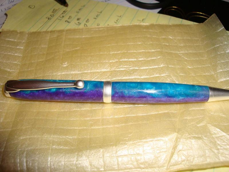

I finished my 1st PR cast pen today. I wanted to swirl the colors a bit. I waited for 20 minutes before adding the 2nd color, but it still separated. I even toothpicked it after about an hour. On another attempt, I tried waiting a bit longer. it was still soupy, but I found CHUNKS in it that were hardening faster than the rest. I want colors to swirl around without blending or sinking. what to you think I might have done wrong???

A few questions for you. How much catalyst did you use. Did you mix it in well. I usually mix pigments to get the color right and then add the catalyst. If it is cold in the shop it will take much longer for the heat reaction to go. The chunky comment is suspicious for either not enough catalyst or improper mixing. You need to be cautious to not add too much catalyst because this will make your blank brittle. I wait for the resin to start to thicken before stirring the mix. It is a waiting game and sometimes the reaction is relatively fast. You can add a gelling agent but that stuff works fast and you need to use it sparingly. I will sometimes add gelling agent to one color and leave the rest regular.

never heard of any gelling agent, where do I get it? as far as mixing, I used a drill and wide stick for over a minute without the catalyst. so I know the color blended, then i added 5 drops per ounce cuz it was 3/4" thick. I only hand stirred that, about like i would beat an egg. the finished product is 3/4" thick but since I am pouring the colors separately, should I use the cat. according to individual thickness?
HA HA!! spirit...dont use tiny glass beads either. wrecked a good skew, trying to get a little sparkle:eek:...alot of Q's asked, lets see if I can answer.
PR and colors from artstuf.com...about 75 degrees at the time, plus I hung a lamp about 4 inches over my mold. used aprox 1/4 teaspoon of powder pigment for 3 oz. of resin, with 5 drops 15 drops of catalyst per 3 oz. I went with 5 drops per oz. because once I poured all the colors, it would be about 3/4" thick...forgot the rest of the questions...TEE HEE!!

Ok, here's my $0.02 on this:
1) He's fine on amount of MEKP and amount of pigment
While he may not be perfectly repeatable, he's within the
limits of reasonable casting.
2) If I'm reading what he did right, he mixed the 1st color, waited about
20 min then mixed the 2nd color. After about an hour he ran a toothpick through it.
I'm guessing he's well under 70F if he can toothpick it after an hour.
So why'd it separate? Because he didn't have *both* colors gelling at about
the same time. If I can get to them I'll scan and post some blanks I poured
when playing with the Pearl-Ex pigments- I think they're what he's after. I think
that when he talks about "Chunks hardening before the rest", he was hitting pieces
of the 1st color while toothpicking the 2nd.
Timing the gel can be the hardest part of a swirl, especially if you're trying to keep
the colors more distinct (and hence push the timing closer). Some 500W halogen
lights have helped me out of a few cases where things weren't gelling in sync.
I did a recent 6 color pour the size
of a softball that had a clear core and numbers that would be visible from the outside-
and all had to be timed to gel hard enough to work with but still be green enough to
have a chemical bond throughout.
I agree with Jason.
I would mix both colors at the same time, wait a few minutes, and then pour one then the other into the mold. I'd then give it a swirl and cross my fingers.
I agree with Jason.
I agree with both Jason and Steve (haha),
Mix your two (or three) colors at nearly the same time .. maybe staggering each color by the time is takes to add catalyst and completely stir Color-ONE, then add MEKP and stir TWO, then THREE, then, in a little while, let the good times roll, mix them all in some creative fashion ..
