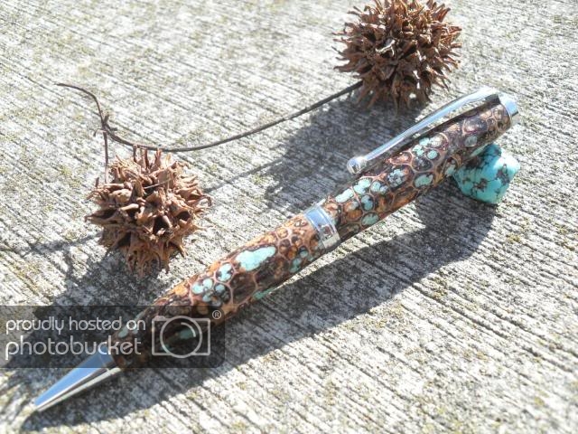

one i made recently, inlaid turquoise and gold mica with CA

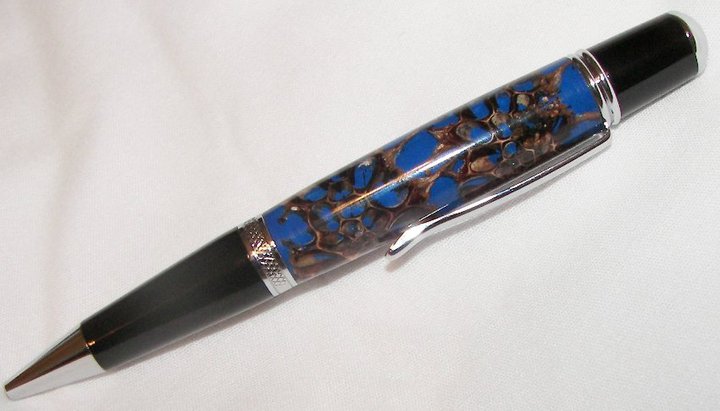

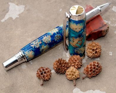

These are real similar to sweet gum pods. I can't find my sweet gum pics. This is Cook Pine pods. I just stuck them in a single square mold and used alumilite and pressure to cast them.

Zander, I have thought of trying to turn those sweetgum balls and now I'm going to try one but one question, Is the turquoise crushed or powder form? I've never used that before and where do you get it at? Thanks.

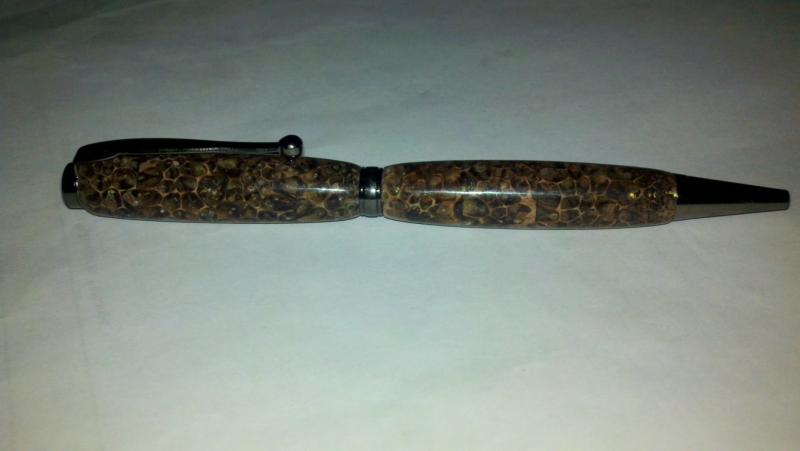

Here is one I did about 6 month a go it was my fifth pen. I wish i would have reversed painted the tubes. I really like the look of the jade filled one also but what can you say for my fifth pen it came out ok. I have been thinking about doing another one and using 5 min epoxy with embossing powder but just have not had the time.

Now THAT looks cool. I love the "hollow" look of the clear resin. For a fifth pen, it ain't too shabby! Heck, it looks better than many of mine WELL past the fifth one...
Somebody please explain to me what "reverse painting" means.
Reverse painting is painting the inside of the hole after it is drilled. I take a can of cheap spray paint and spray it in the hole. But, I've also used model paints and even some of my wifes nail polish to get the right color. I also paint the tubes just in case a bit of paint scratches it will have a back up.
