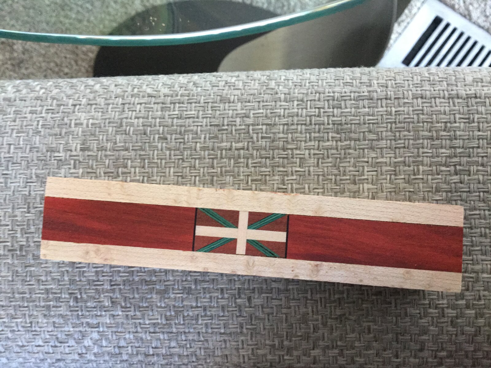

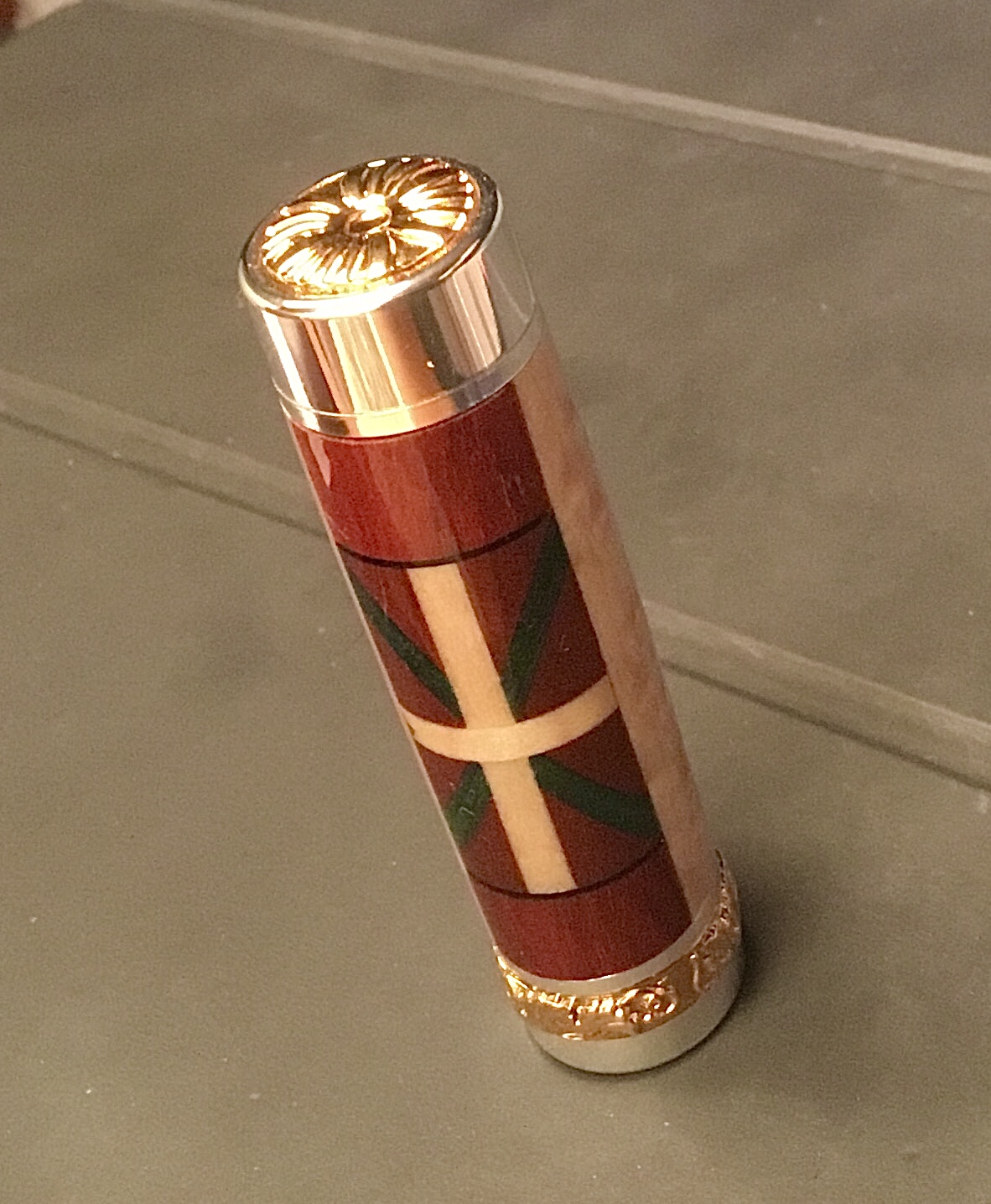

Hi folks:
Awhile back I made a pen for friend of Basque heritage and attempted to incorporate the Basque flag (red with white and green intersecting bars) in the cap. Photos of the blank and cap are attached. I used maple for the white cross pieces and jammed three pieces of dyed green veneer into the saw kerf for the other pieces, which looks...well...just okay in my opinion. I wonder if any of you have better ideas for the green part. I do not have a vacuum set up to penetrate dye deep into wood; was just wondering if there are other materials I could use to cut width of my saw kerf, or resources for thicker pieces of dyed wood.
Thanks!
Russ
You can buy plastic sheets (file card size) at BearToothWoods. . I think they are about 0.025" thick.
You could make some paper Micarta using quality card stock that has a colored core. Most card stock has a white core, this is NOT what you are wanting. You want solid colored core paper.
Or you could dye wood veneer and glue it up to the thickness you want. But the dye has to go through the veneer, maybe an alcohol leather dye??? Maple veneer, soaked for a day or 2 should soak through. Fiebings alcohol based dye would be my choice to try. NOT the oil based dye.
Geez, you guys were up late! Thank you Mal. John, Dogcatcher. Colored card stock, plastic sheets (looks like the Juma plastic sheets are fairly thick) and I will give some of them a try. 👍🏻
