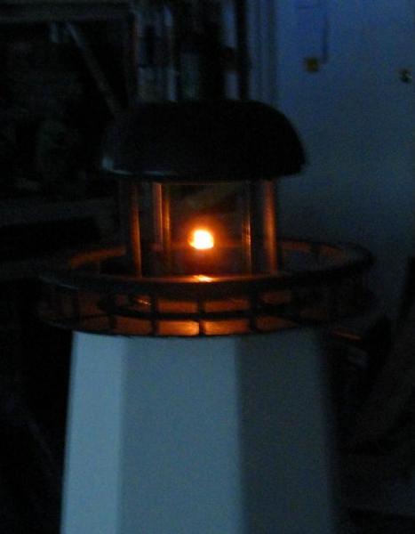

Does anyone have a schematic for building a mini 9volt led strobe? I have to have one done by Tuesday evening for a school project for my son. I have one built but it won't flash, I'm not sure if my NE555 chip is shot, I'll be picking up all new parts tomorrow. If anyone can help, I would really appreciate it. Thanks
We got it done and it works great. The teacher better give him a good grade for this thing, he did most of the work and I just gave him a hand with some of the more intricate detals. Not bad for a 12 year old.

Thanks everyone, I was able to build the one I was working on, it had a bad 555 chip. I'll post some pictures later
Good job on helping your son.:highfive:
The kid got an A+ for the project and was asked to loan the lighthouse to the school for the time he is there(2 more years) to be placed in the trophy case as you come into the school. He is all grins.
