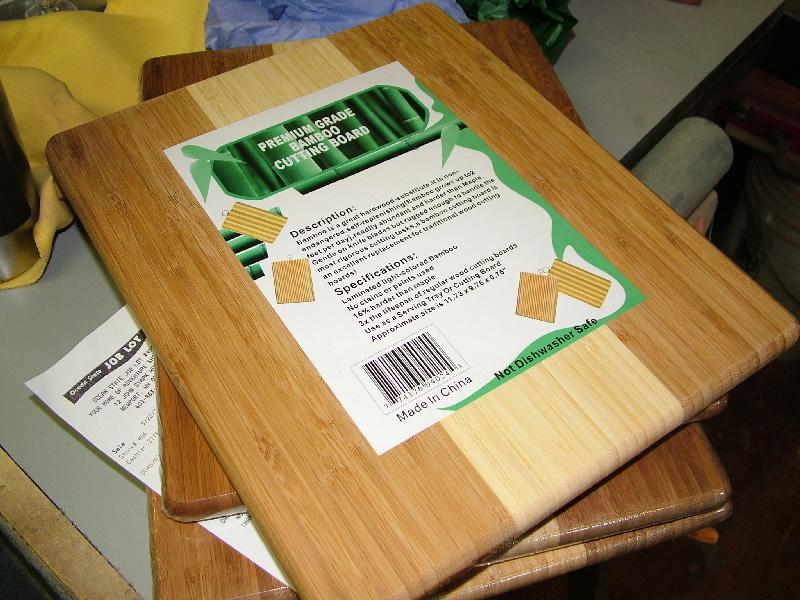

I stopped into a dollar store and saw a bunch of cutting boards that were pretty cheap. I bought one, brought it home and proceeded to condition it with the mineral oil.
It was made of bamboo, and it liked the oil. The capillaries in the bamboo flare when the light hits the oil .. looks like little tiny fiber optics throughout the board. So I got thinking..
I brought it into the shop and cut it at an angle. It cuts a little ragged, after all it's not wood, but a grass. But it drilled fine. I put it on the mandrel and turned a cigar pen.
It turns well, sands quickly and has a lot of character in it.
I'd post a pic, but it is still sitting on the mandrel soaking up tung oil for a finish. It would probably do just fine with a CA finish, but I want the oil soaked in first. It really makes the pen light up.
anyway, the cutting board was $2.99 and I got about a dozen blanks out of it. An added bonus is that there's two different colors in it. I'll post a pic when it's done.
Oh, don't bother going to the store near me, I went back and bought all of the cutting boards. heh heh heh ..

I went the more expensive route and bought two different ones from walmart. The first was pure bamboo and I got about 30 3/4"x3x4" blanks from it. The second was supposed to be half bamboo and half acacia. Turned out to be about 1/5 bamboo but I am hoping to do some creative drilling and keep both woods on the finished pen. I haven't turned any of it yet but I wish I had known that you can get them cheaper at other places.

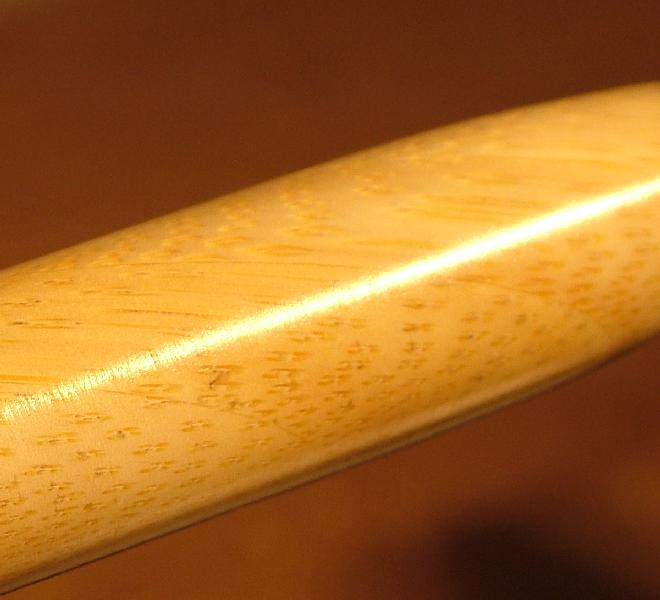

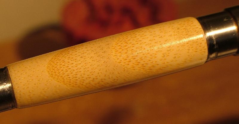

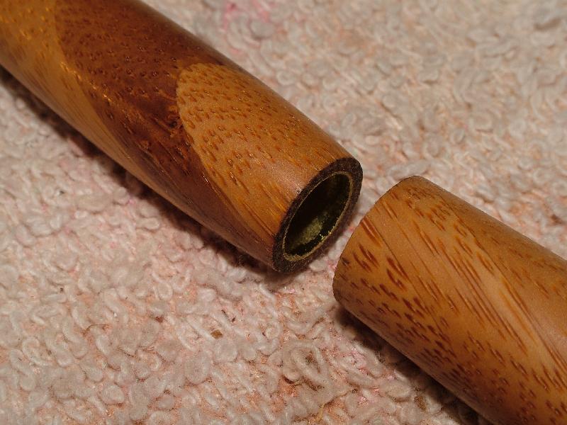

and another one.
You can't really see the light catching the capillaries in the photos, but in one of them
you can see a little bit of it. Looks like pores.
