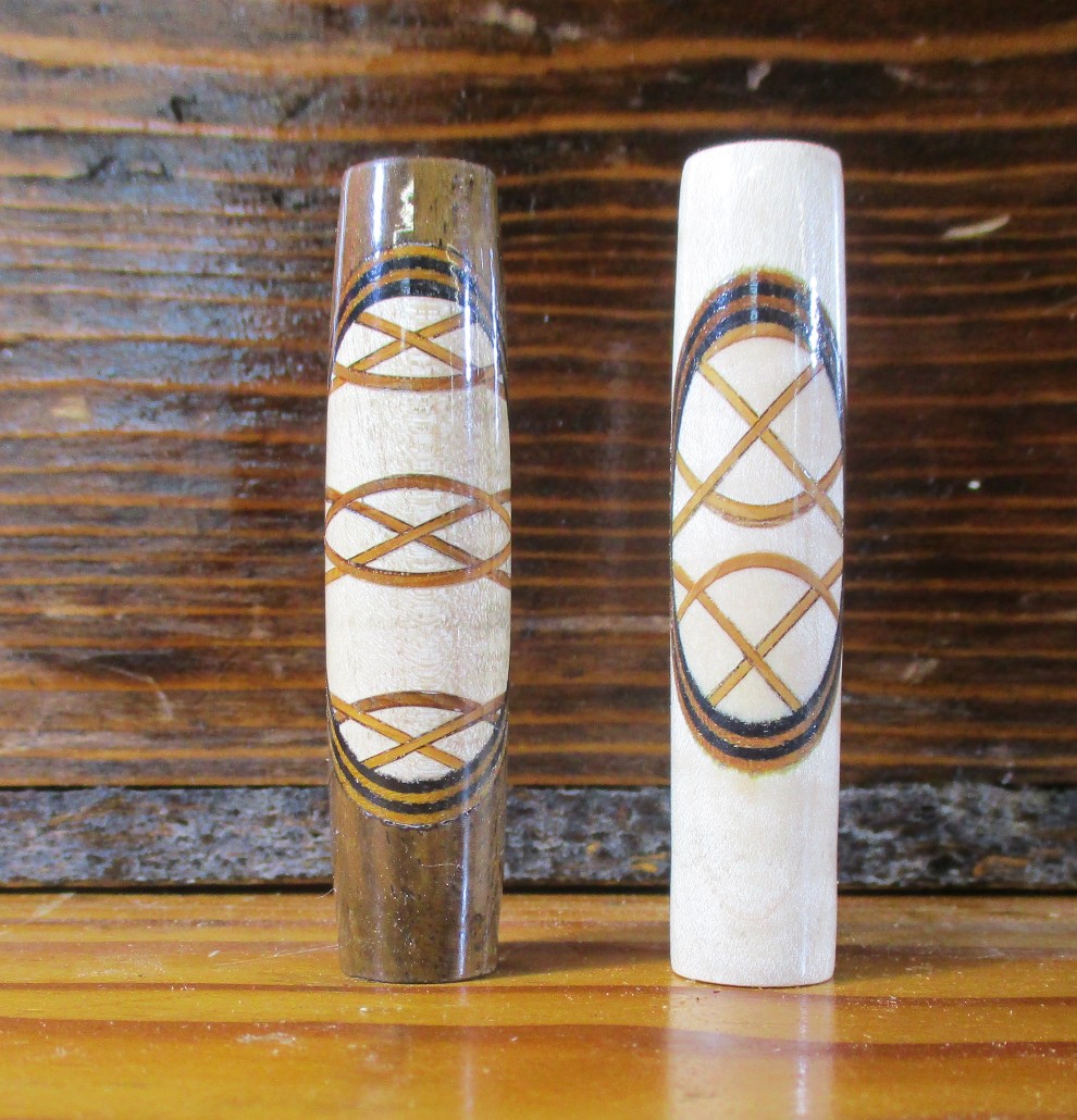

I have not finished trying to do something a bit different with the old celtic knot.
These won't see a pen kit as they need re-worked. The gaps are too far apart, I think.
Critiques are valued.
Alan

Definitely a different look. Like what you are doing. You never know what the next trending idea will show up. Keep at it.
Alan, those blanks are really VERY LOVELY, and VERY well worth turning into pens, from what I can see !!!
Thanks very much for doing the experiments and making us aware of them !!!
COMMENDABLE new ideas !!!
It would seem to me that a lot of careful planning and VERY CAREFUL WORK went into both of those blanks !!! . . THANKS AGAIN !!!
Superb concepts Alan. These beg to be refined as they are very unique. I love your creativity. Be well Mate.
Alan
I find myself drawn to the right hand one. The left hand one looks too open (?) to me ? In the right hand one the banding " frames " the knots and I think that's what appeals. Nice work though in both cases
