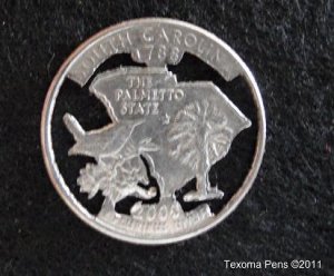

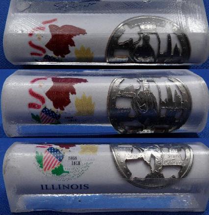

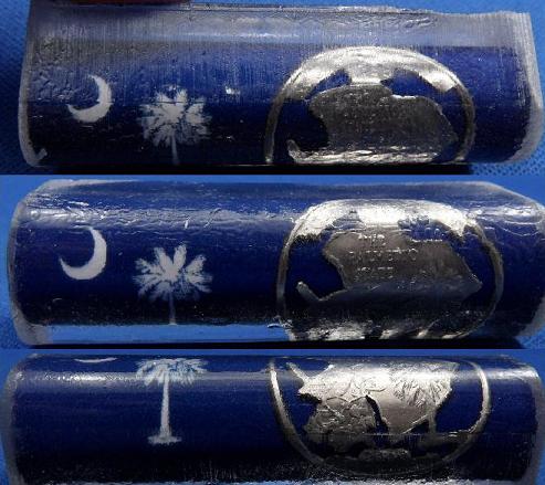

Many of you may know that I like to indulge in the cutting of state quarters and casting them in resin to make what I call "State quarter pen blanks". So here are a couple that I have created for a couple of buddies that have made some fantastic trades with me! The blanks have been squared so that may impose on quality of the pic, but it gives you a general idea of the work involved.Also, the background images are each states flag. I know a few of you in this group that are scrollers and can truly appreciate the work that goes into each quarter. Hope you enjoy looking! Any comments, critiques, criticisms welcome! And in case you are unsure, these are REAL Quarters!

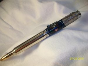

I made these for the Sierra pen kits, but I have also done them for Navigators, Jr. Gents, Cigar or Big Ben, My "Upshaw Hybrid" pen kit design( this can be seen on my website in the pen gallery either labeled "Upshaw Hybrid" or congressional pens, or like this pic.......

Thanks Jeff! It truly is a challenge on each and every quarter. The Illinois quarter took three tries before I got it right. There were some super thin areas in there like Lincoln's head, that would snap off just from the up and down motion of the blade. Remember, these quarters are 1/3 the thickness of a normal quarter, so its almost like trying to cut aluminum foil.:eek:

WOW to all of you! Listen, I was just piddling around in the garage and thought I would try this idea and it worked! thanks for all of your kind compliments.:bashful: I typically cut these using the smallest scroll saw blades with the most teeth or a spiral blade. both are my preference. did i mention that the Illinois qtr blank took three tries. the problem is, the process i use to shave them down is nowhere near what everyone thinks and takes me around 15-20 minutes to perform. Then, the cutting process is about another hour if I stay focused and dont let my A.D.D. get the best of me:biggrin:, but there are so many variables and things have to be precise to achieve quality results. (Rambling on...) there is alot of planning that goes on to make each one. then there is the casting process, which has its own difficulties. Had it not been for PtownSubbie's "New and Improved" molds, I may not have been able to have made some of my casting progress with these as of recently. I know lots of you have questions and I really appreciate your curious minds! I still have other things up my sleeves, feel free to check out my pen gallery on my website to see some pics that I haven't posted on here.

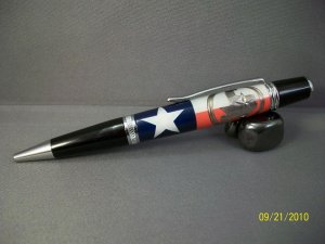

Probably my most popular blank is the Texas qtr pen blank!

below is the south carolina qtr after being cut.
