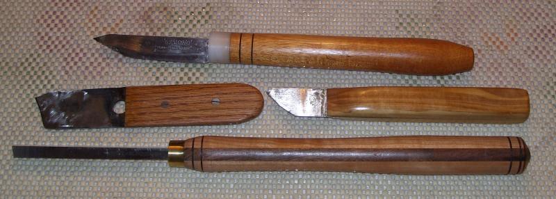

Homemade Parting Tools
Here are a couple I've made. I also made the handles. The 1st one was a blade from a lawn edger. 2nd short one is a piece of sawmill bandsaw blade. Long blade is an old carving knife, bottom tool works like a Bedan...
They all work well, each has a different use as some are flat ground and some hollow ground. Flat ground gives you a cutting spur on each side...

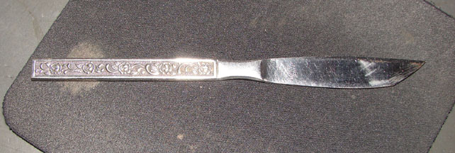

There is another similar thread going on right now also.
I tried posting a picture of my table knife/parting tool but messed up the sizing.
Here again. I will agree, the handle is small but I do not attempt to use this on large, heavy pieces. That would be dangerous.
