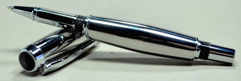

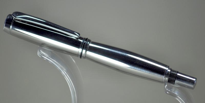

Hello,
Here again with another Barron, this time in stainless steel :cool:
Please let me know what you think.
Thanks for looking.
Are the barrels out of round, or is it the reflections?
I knew it! I don't know what happen both barrels lopsided. I did figure out the finish though the only bright spot in this misadventure. Lowe's sell metal finish compound in grades 1-6. Basically a solid of clay, wax and sand that is supposed to be applied to a medium buffing wheel. Well if lightly rub a fine layer across your spinning finished blank then take a paper towel and remove. Beautiful result. Cause' I don't have a buffing wheel.

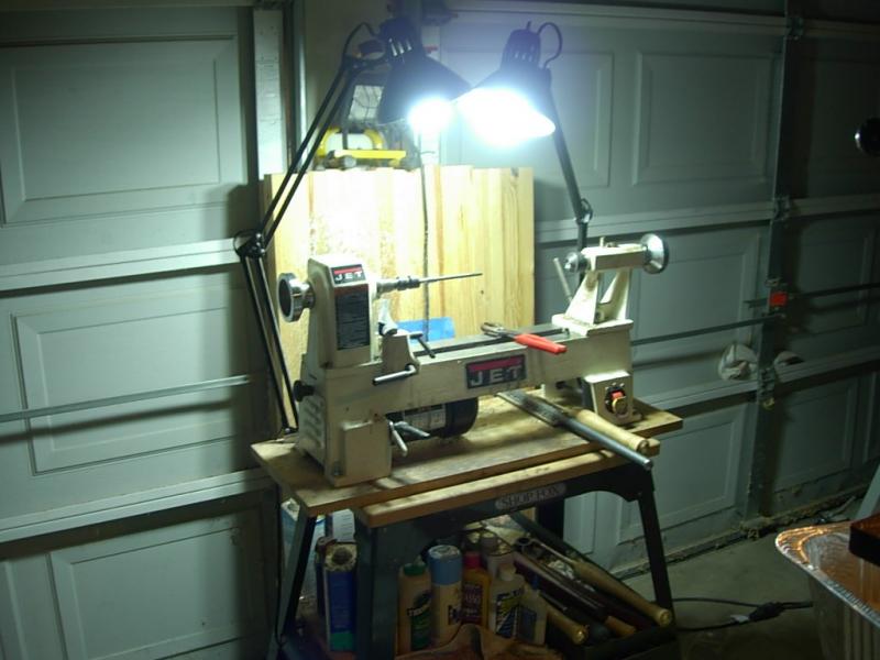

This was turned on a wood lathe. JET 1024, not modified.
With hand held tools.

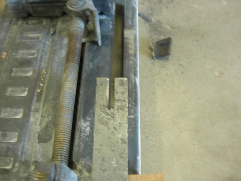

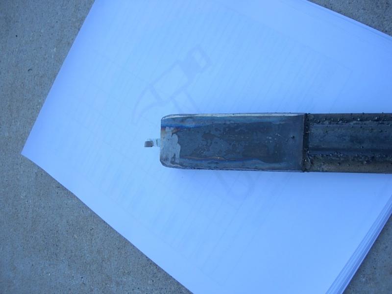

I made the tool. Very heavy construction 1/4" plate 1" wide, all welded together leaving a square opening centered at the end 1/4x1/4 inch for the carbide insert. Then that welded to 1/2" steel bar, 22 inches overall. I searched high and low for hand held tools none exist. I am thinking of selling them. On the three pens made and posted here over a thousand looks, surely someone would buy a tool?
The other thing I found was the finish was made smoother, the deeper cuts I took. I think it was due to heating the metal. The pictures don't tell but the cap was turned first using little timid bite, the body was turned taking agressive bites with finer string like shavings that turned blue and red due to heat. (I saved those to cast with some alumlite) It was a much better finish. I sanded from 150 to 12K and the metal finishing wax made the difference.

Pen looks good although a little fat for my taste. I noticed the out of round which might have been caused by too much side pressure. Maybe you should try a gentler touch with a file instead of a carbide bit. No doubt will take longer, but time is not that important.
A metal lathe is nice for straight lines and drilling nicely centered holes,
but whenever I use stainless ( very often) a med or smooth file is my tool of choice when I want curves. It 'turns' down a lot quicker than you might think with a file and is very easy to control.
I think you did a neat job on it:biggrin: Well done.

I did. Just some 1/4" by 1 steel plate welded together with a slot cut in the end and a piece of round bar welded to that. Heavy and crude but effective.
