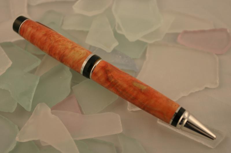

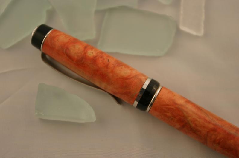

I'm stabilizing blanks 24/7 right now. I've done a few hundred so far, and the Minwax works for me, although it's a bit expensive. Wish they sold it in gallons. Vacuum is best, And don't bother with antler. CA works fine on antler, and it's not hard to turn untreated, plus it will discolor the whiteness of the antler. I put up to about 40 in a 5 qt. bucket and fill halfway up with Minwax and vacuum for 2 days, then turn over and vacuum for another 2 days. Some do it for less time, but I'm in no rush, and if it doesn't soak any more up the material's not going anywhere. I have 2 vacuum pots going right now, and frankly it's opened a whole new world of wood I can now use for pens that I put aside because they were too pithy, soft, or wouldn't take a good finish. Here's an example of one of those blanks-it was REALLY soft before I stabilized it, and was tough to get a good finish on. This turned like plastic and finished like glass after stabilizing. Plus I've been told the red won't be so prone to go away in time after stabilizing. It's spalted, flamed Box Elder Burl.
