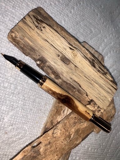

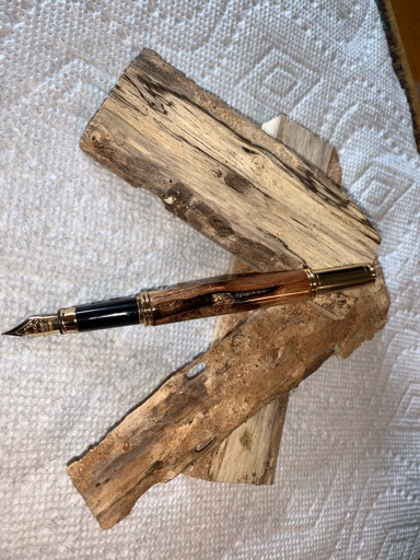

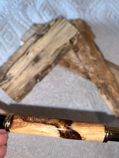

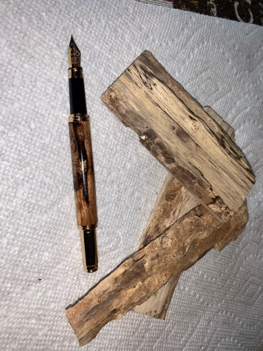

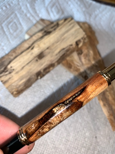

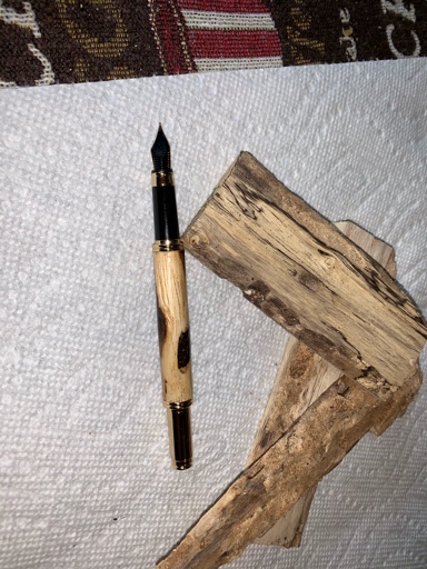

Here is half of the finished product. The monkey pod turned well. However it had big critter holes in it and I tried to fill the void with CA and the turn shavings. It's ok, not great but overall I think it looks good. The cap didn't have as many critter holes but I was using a new carbide tool and took a little too much off. So I turned the wood off of the tube and will try again with another piece. The grain won't line up as well but hopefully it'll still look good. I'll try the mango another time. It doesn't look to have the same voids.
