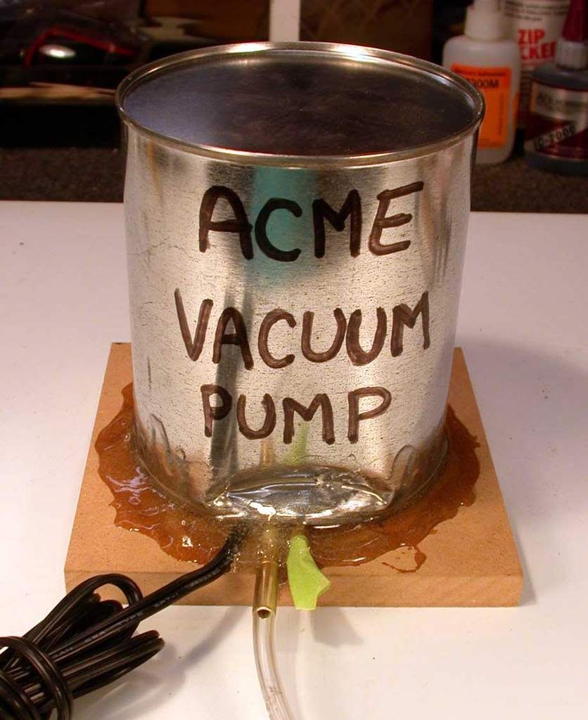

I'm thinking of cobbling together a cheap vacuum system for stabilizing with minwax wood hardener. There are a variety of cheap commercial vacuum pumps (the little reynolds food saver, the pump-n-seal) and I recently saw this post over on the rc forums about a cheap diy vacuum system made from an aquarium air pump...
http://www.rcgroups.com/forums/showthread.php?t=966524
It only pulls about 5-7 inches of mercury, but that might be enough for stabilizing with a substance that penetrates well. I've read about people stabilizing by just tossing the blanks in a can of wood hardener and leaving it there (no vacuum)... surely 7" of mercury beats no vacuum at all :). I'm not sure it will be any cheaper than a reynolds machine at walmart though, I need to go price them and see.
