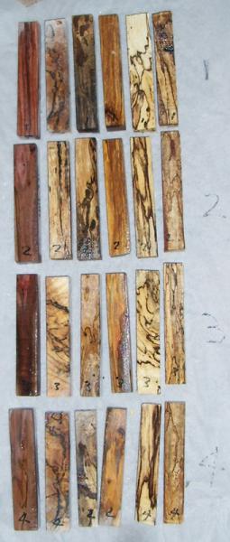

I agree with Curtis, I have stabilized heaps of rotten, wormy, falling apart dead, blanks with CJ, all with success. The main thing is to ensure they are dry before you stabilize. Attached are some I am currently selling in Aus - 4 x 5 different spalted timbers (some not stabilized though)
Cheers
