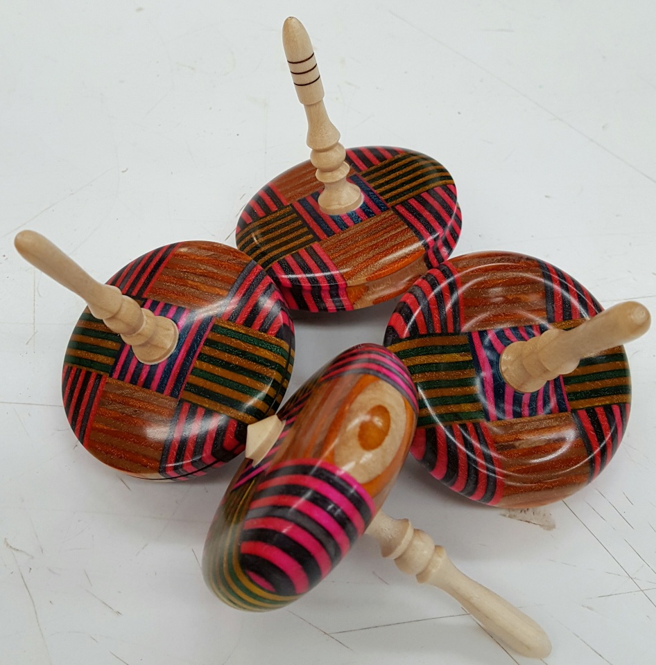

I've stabilized some and had the colors run between dark layers to light layers. Anyone else experience this?
Rick I do find the colors are a little muted in the cross grain after stabilizing. Doesn't seem to affect the long grain. Is this caused by colors running together? Probably.
I stabilize all my spectraply, it darkens a little and some colors run, some do not. I do a lot of segmenting Gisi style and after putting in all that work it is a bummer when the spectraply breaks and chunks come out. That happened the first time and I have stabilized since then. Did not happen with diamond wood.
