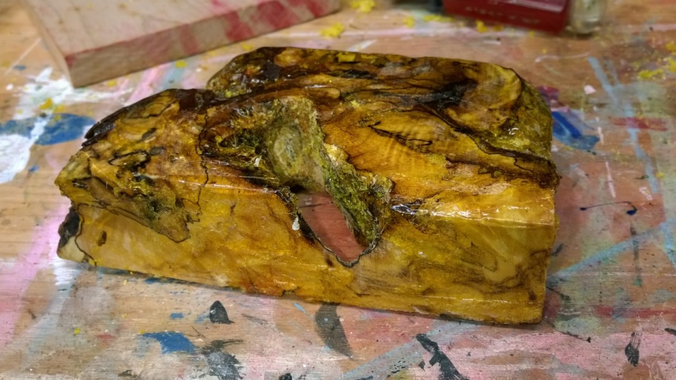

How do I remove the Cactus Juice that sets up in the cracks and crevasses before casting? Picture attached of one I stabilized today.

Contrary to what someone said before here, stabilizing can fill lots of small cracks and when you want to cast that piece/blank, as in the case here, the bleed resin is a problem to get rid-of in those cracks but also in surfaces where is a lot of "spikes" as in burl caps and other flaw surfaces where the dry excess cactus Juice dries/cures on.
Is not always possible to clean those areas without causing some damage on the wood and the time it takes is just ridiculous so, how can you avoid the excess resin to become a problem...???
Firstly, you have to understand that, only some of the Juice inside the wood will stay there, the rest (excess) is repelled/boiled out of the wood and will be captured/retained if the wood was wrapped with foil so, you need to make sure, your oven as a "overflow" tray or you have to make one up to keep the juice from dropping on the oven's bottom heating elements.
That should be avoided at all costs, it may not turn into flame but, it will smoke ferociously and when fully hardened, you will have a hard time cleaning it without destroying the heating elements...!
The principal is simple, allow the excess resin to flow away from the wood/blank, that normally resolves the issue but, if you piece has lots of crevasses, make sure they are pointed downwards so, instead of trapping the excess juice and harden in there, it will run off and keep those crevasses clear for the casting resin to fill...!
I hope this helps you...!
PS: I only recommend this "unwrapped process" in situations explained above, for any normal wood stabilizing, I recommend to have the wood wrapped with the foil paper, there are some advantages with that, firstly the excess juice is contained and therefore does't mess out inside your oven, the wood won't stick to other pieces, the wood will get a slight better results, the heat is maintained within the wrapping in a much more controlled manner, any of the juice that may be expelled at first, when the wood get hot, will have a chance to penetrate the wood again as the wood porous open due to the heat, if it runs off the wood in the unwrapped situation, that juice can no longer return to the blank (unless Curtis come out with a way to make the juice to "walk" back up...!::eek:wink::biggrin:)

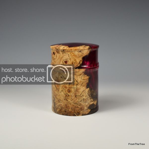

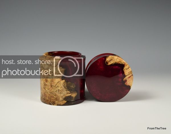

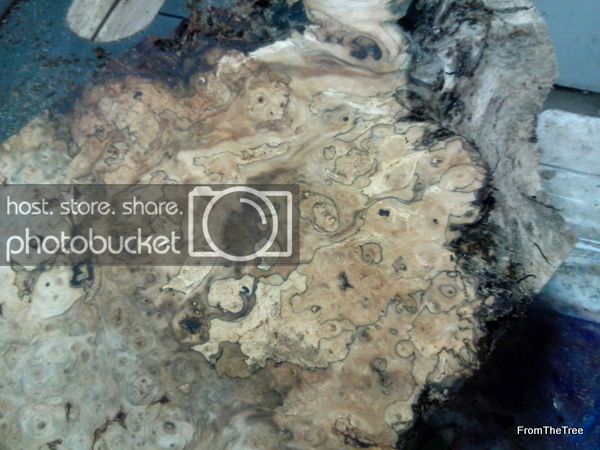

If i have a stunning piece of natural edge burr buts its gone too soft/punky then i need to stabilise it so that it is hard enough to turn once its cast with the resin, if i dont stabilise it the colour from the casting resin will seep into the wood and when its turning (if the wood doesnt fly apart) then the soft wood will break away from the resin or be too soft and create a problem with an uneven surface.
a good example of this is the burr horse chestnut i had to stabalise with cactus juice before i could cast the blanks to make boxes like this one
the burr was very highly figured but had been outside for several years and had gone like balsa wood, an average piece increased in weight by 250% by being stabilised.
it was so soft in places that when i went to blow the dust away with my compressor after cutting it... it blew chunks out of the wood!!
