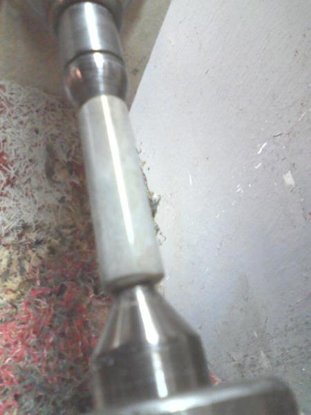

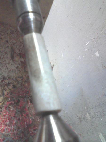

I tried it. I like it. I'll continue to do it.
I looked for previous posts about this, and all I could find was someone saying it discolored the antler. So I decided to try on some small pieces to see how it worked, and I have to say it worked really well!
I didn't notice any discoloration at all- that is, except for the pieces I had submerged in a dyed solution.
The marrow was much more solid that it usually is. I was able to get clean cuts on the marrow without any chip out. I tried both a scraper and a skew, and both worked on the material well.

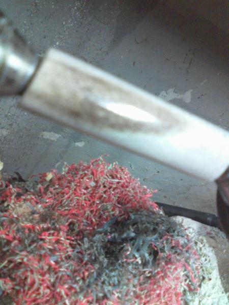

Then, I just polished the antler, and was able to get a high gloss shine. The outer layer remained gray in color, and got the best shine because it's the less porous of the two parts. But the marrow also took a shine, even if it's obviously more textured due to it's porosity. The marrow can also still stain, and you can see in the picture where not using a super clean rag while wet sanding with MS dirtied the antler. Though I don't mind the look, personally.
Anyways, I was impressed with the level of shine it took, and I'm thinking that I'll be using this method for all pieces going forward. I got good penetration all the way through, with only the hole drilled in the center of the antler section. I used cycles of vacuum and pressure, only going up to 50-60 PSI with the HF pressure pot.

I used an acetone/ plexi solution. 2-3 cycles of vacuum and no pressure, then vacuum to pressure for about 30 minutes, then vacuum for 24 hours, pressure for 24, then let them dry out.

Did the marrow fill with plexi or did it remain porous?
Well, I want to make sure I get plenty of penetration, and I'm not in a hurry. (and again, I did one large batch with a bunch of antler).
But yes, the solution does get into the marrow, but it's too thin to actually fully fill the marrow. The picture doesn't show it, but the marrow will take a high gloss shine, but it'll be textured.
I may try to fill the small gaps with thin CA and sand down like you do with a money/ bucks blank, but i haven't turned any other pieces recently.
