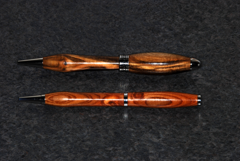

By the way, I have attached a pair that I just made for my family from almond wood. My father grew up on an almond orchard and this has sentimental value for us. I made one for each member of the family and these are from the same tree. Beautiful yet VERY dense wood. It was very resistant to CA and took lots of patience and the thinnest CA I could find before it finally penetrated the grain. Almond pens.jpg

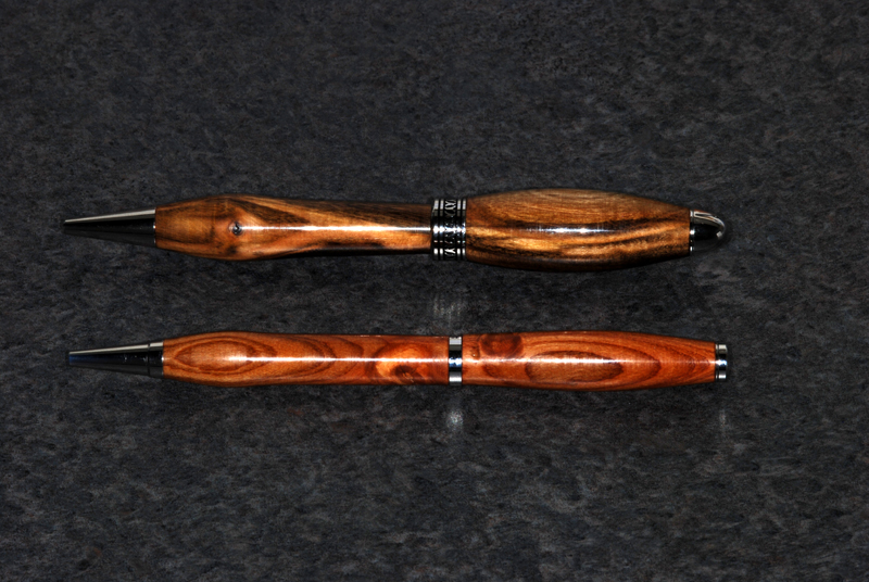

By the way, I have attached a pair that I just made for my family from almond wood. My father grew up on an almond orchard and this has sentimental value for us. I made one for each member of the family and these are from the same tree. Beautiful yet VERY dense wood. It was very resistant to CA and took lots of patience and the thinnest CA I could find before it finally penetrated the grain. View attachment 41476
Hi scotty,
Those almond trees should have been quite old to produce such a heartwood colouration and grains, I know because I have a "fair" amount of almond wood, most is from trees that were pulled out on the 28th year of plantation, and the same orchard had a few trees that were part of the very first lot of almond trees planted by that family in that location, about 75 years ago and no doubt was a hell of a difference between those 2 woods...!
Yes, almond is very dense and the older the wood is the denser it gets but is extremely pleasant to work with and takes a finish very easily, in fact, sanded up to 600 grit, the back of the sandpaper will burnish enough using friction polish style, the only problem is that the wood would not be protected from stains, dirt and all other sort of stuff, pens get submitted to, particularly when used.
I like to use natural oils to finish almond, the grains just pops up and a couple of oil coats will protect the wood "reasonably" well for some time. If a more durable finish is required, one should remember that most varnishes will not soak into the Almond at all, staying at the surface like a plastic film that can be damage (separation) if the varnish has not elasticity.
I better way to give to Almond wood (particularly old wood) is to use thinner CA as possible and instead on coating the wood in the normal CA finish way, I would suggest to pour the thin CA in the blank while the lathe is turned off and using something to protect you finger (the one rubbing the CA) to spread the CA all over the wood by rotating the shaft wheel, chuck/mandrel (whatever you have) slowly as you spread the glue and don't use accelerator, you need the CA to soak as much as possible into the wood.
Be careful with any excess CA on the lathe base so use some news paper or identical to protect it. While after this soaking coat is dry, a medium CA could be used, I still suggest to continue using the thin CA for any further coats. A LIGHT sanding with 320 or 400 grits will be require after the "finger" coating application to smooth things out, but not sand all the CA off...! gently.:wink:
