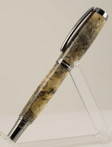

The blanks turned extremely well, producing a fine powder as the blank was turned. The blanks took a very nice CA finish and polished well. I did not see any noticeable pin holes or other problems with the depth of stabilization. The stabilization fluid appears to have fully penetrated both pieces.

Rick, I see two excellent pens posted. My fav is the buckeye burl. That would have been one mean blank to turn had it not been stabilized, I bet. It is beautiful in finish and the fit is right on. The maple is one very nice pen also, but, next to the Buckeye, well, even if it is red, that Buckeye is outstanding. Sorry.

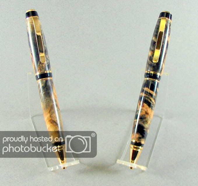

Pen on the left is polished to 12000 and finished with friction polish. Pen on the right is 6 coats of CA. Both are buckeye burl. You decide.
