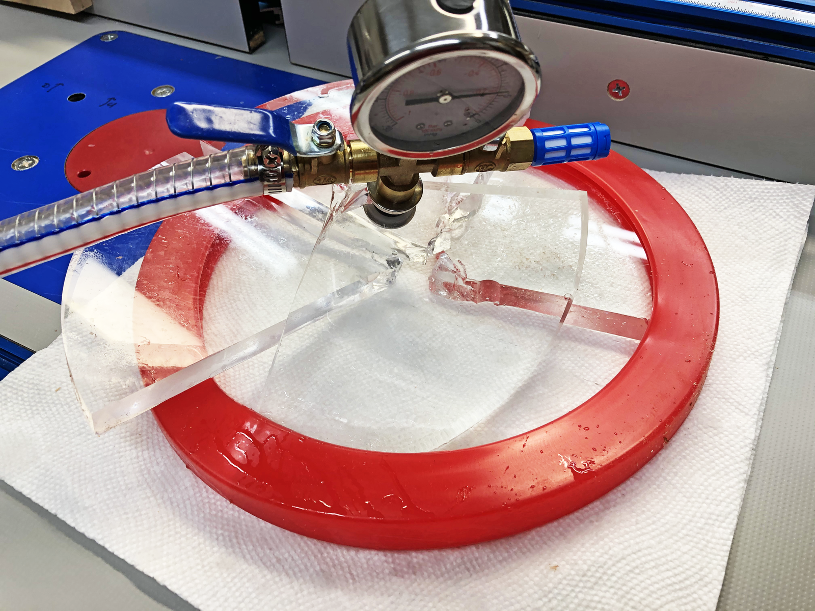

Sorry, I have no experience with that particular brand, but is my experience with lid materials used on vacuum chambers built out of big stainless steel pots:
I started out with a chamber I bought online. The advertisement said it had an Acrylic lid. The lid was 10-inches in diameter, 1/2-inch thick and had the gauges and outlet mounted through a hole in the lid. On my first run the lid imploded - Ka-Boom! - Scared the crap out of me, ruined the vacuum gauge, and splattered Cactus Juice all over my shop. Plexiglass is a true Acrylic and in my opinion is not suited for this application because it is somewhat brittle and is prone to cracking under stress, especially when holes are drilled through it.
I bought a 1/2-inch piece of Polycarbonate (Lexan) as a replacement because Polycarbonate is a much tougher material and handles stress much better than Acrylic could ever do. At the same time, I bought a good quality step drill and drilled a hole in the side of the chamber (a big stainless steel pot) and mounted my new vacuum gauge assembly through the chamber instead of through the lid. Two big improvements. After a few batches though I noticed the inside top surface of the lid started to look a little crazed on the surface. I read somewhere that the solvents in the Cactus Juice might be starting to degrade the surface of the lid. Ok, I was still a little nervous when I used it because of the implosion and all, so...
I bought a 1/2-inch glass lid because no solvent I would ever use in it would even dare to compromise the integrity of glass. I think I would have been OK continuing to use the Polycarbonate, but I have much less apprehension about the glass lid.
I'm sure that many people that stabilize are successful with Plexiglass and Polycarbonate lids, even those with holes drilled through them for the hardware, but I find the process less stressful by using the configuration and materials I ended up with. - Dave

I bought 1 of those kits once. When that cheap lid broke it was like a shotgun blast. The fact it had red dye in it made it look that way too... what a mess

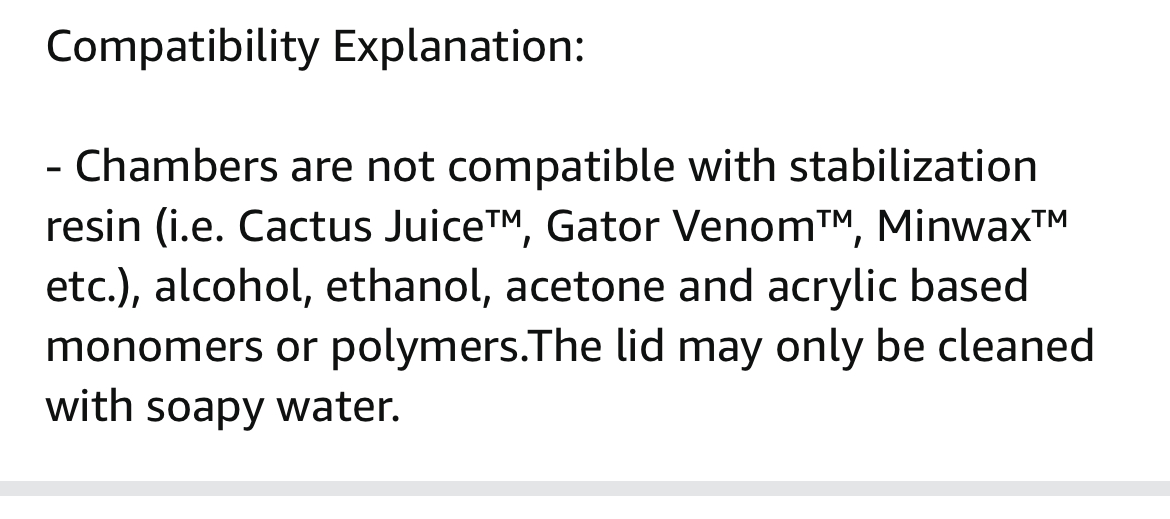

"Multi-application - suitable for degassing urethanes, silicone, epoxies and more
- Strong and durable stainless steel container with chemical-resistant silicone gasket."
Part of description of chamber. I'm hoping this includes cactus juice.

View attachment 322552From Yescom chamber on Amazon.

I have no direct experience but I read that Cactus Juice will permanently fog or scar the surface of plastic type lids and you can not see the bubbles. I bought this one because it has a glass lid which is okay with cactus Juice.
By Lifelong Tech on December 28, 2019

It is just the manufacturer covering their backside. I have used it in this for years now.
By James L. Wright on December 29, 2019
From customers Questions on the unit I purchased with the glass lid.
That compatibility statement is a CYA. I've been using mine since Sept 2020 and have run over 8 gallons of Cactus Juice through it.
