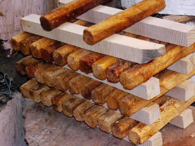

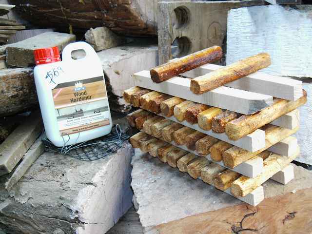

OK, I may have some very soft wood to harden, but when you pour 1 x litre at $69 bucks into a 2kg ice cream container with 5 raws of 6 blanks each, all with the square corner cut out, an the liquid only reaches half way on the last raw at the pouring point, come back the next morning and the liquid is anywhere to be seen, actually just covering the first raw (bottom), you check the blanks and the last raws got half way "wet" on the surface, never had the chance to soak anything as the other underneath drunk all of it before they had time to "taste it" so, they need doing again, the next raw is about 70% and the bottom 3 are 100% so, whatever is left of the hardener in the container after all blanks are removed, is used to soak just enough that second raw from the top that was about 70%. So, 1 x litre gave me 24 fully harden blanks and the top 6 with about 20% done. When I got my second litre container (the last one available) a couple of days later, I manage to complete 60 full blanks in total, counting those from the first lot, as I believe I had a number of blanks that weren't as soft so, soaked a little less!
In all, $138 of hardener for 60 blanks, this represents $2.30 per blank only for the hardener, the blank was originally $1.00 equals $3.30 per blank without anything else, how much do the commercial guys charge for their labor and equipment? I don't know but I know is not free...! and they still make money?:eek:
These blanks are now ready for sale soon as I anticipated, I'm putting them for sale at exactly $3.30 each, how much does a normal stabilized blank sells for, in average?
