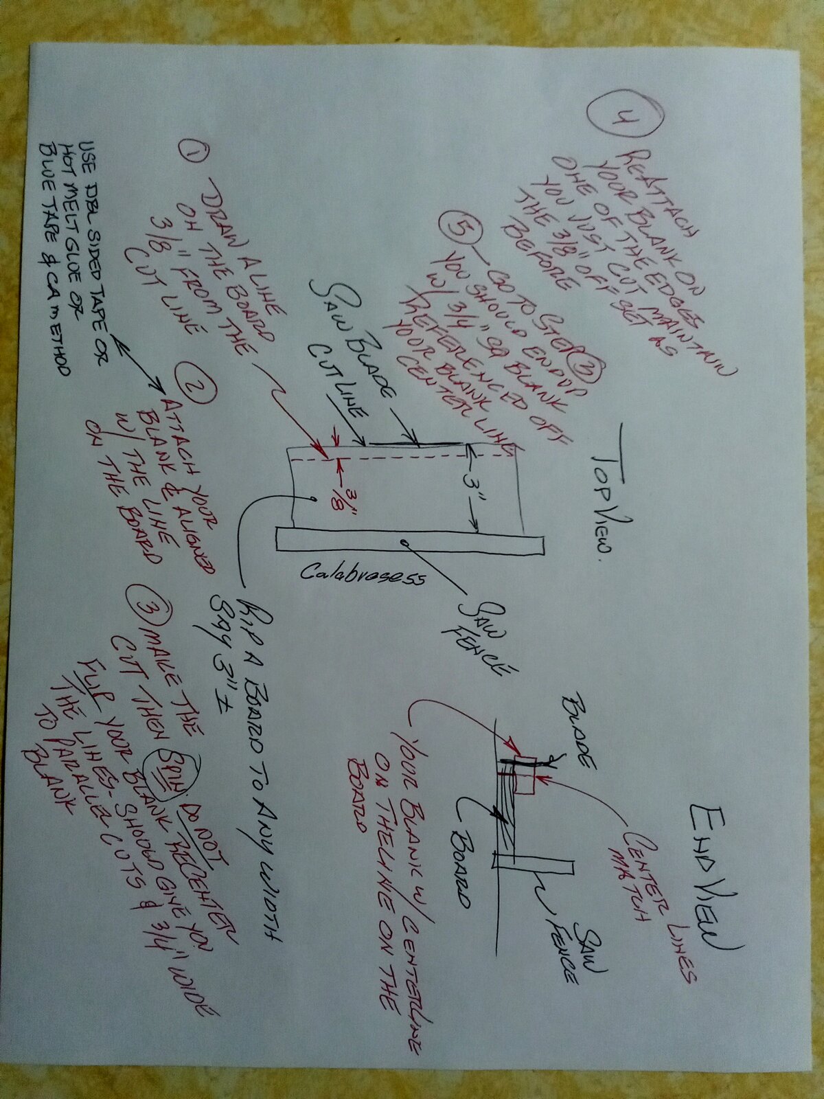

Sand the blank FIRST to get a relatively flat surface first. Do this on all 4 sides now if you can Draw a line on your blank that is the desired center line on one or more sides. Best if you can add this feature on all 4 sides.
Assuming you want a finished dimension of your blank of say 3/4 inch square See my Rube Goldburg sketch for the process from there.

Measure from the center out desired distance and mark a line on all four sides then sand or cut to line. Could make a jig to hold the center point for sanding or cutting.

Very helpful! I think this is the info I was looking for. Thanks
