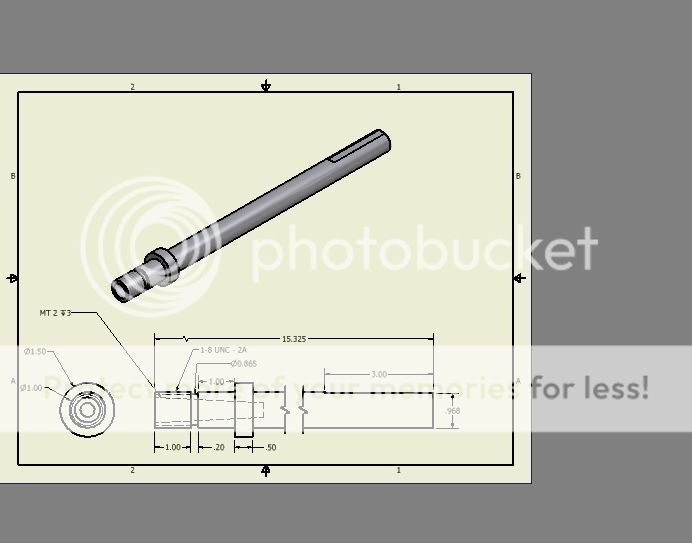

What's the tolerances of a 1"-8 spindle nose? I just got the parts from my uncle for my rose engine lathe and my chuck won't go on. The face plates require a good amount of force to get on. The top of the thread is about 5 thousandths larger than those on the spindle of my lathe. The drawing i made and handed to him i believe was labeled as an H grade.

Sorry must have been sleepy. The drawing was labeled 1-8 UNC - 2A. Randy, this part is from the plans for the mdf rose engine lathe, although i had drawn up my own parts as there were changes that i made to some of the parts. This part for example also has a morse taper.(yeah i know in the drawing there's no knock out bar or nothing, final piece has that fixed.)

Thanks paul will do that, he matched it to a nut that he had on hand labeled H2. The difference could be 2 or 3 thousandths of an inch off! I think i'll stick w/ wood working:D This metal stuff is too complicated[:p]
