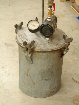

Andy,
Does it look anything like this one? If so, this is a DeVilbiss pot that was made for private label for different companies. I have 2 of them that I don't use. One is labeled as a DeVilbiss and the other is a Craftsman. Both are a helluva lot better than an HF pot and I used the one in the pic below successfully for the first year or so of casting.

Curtis:
I'll try to take some pictures. Mine looks similar but "more hefty" My lid looks much heavier. The lid alone weighs about 10-15 pounds. The bolts attach a little differently, but similar. The pot looks to be about the same age as yours.
I have sent you a PM. I am going to pressurize it, maybe under water to about 45 psi and see what happens. additionally, I have quite a bit of air hose. I can take the pot to a safe place and regulate the pressure from the compressor and see what happens.
