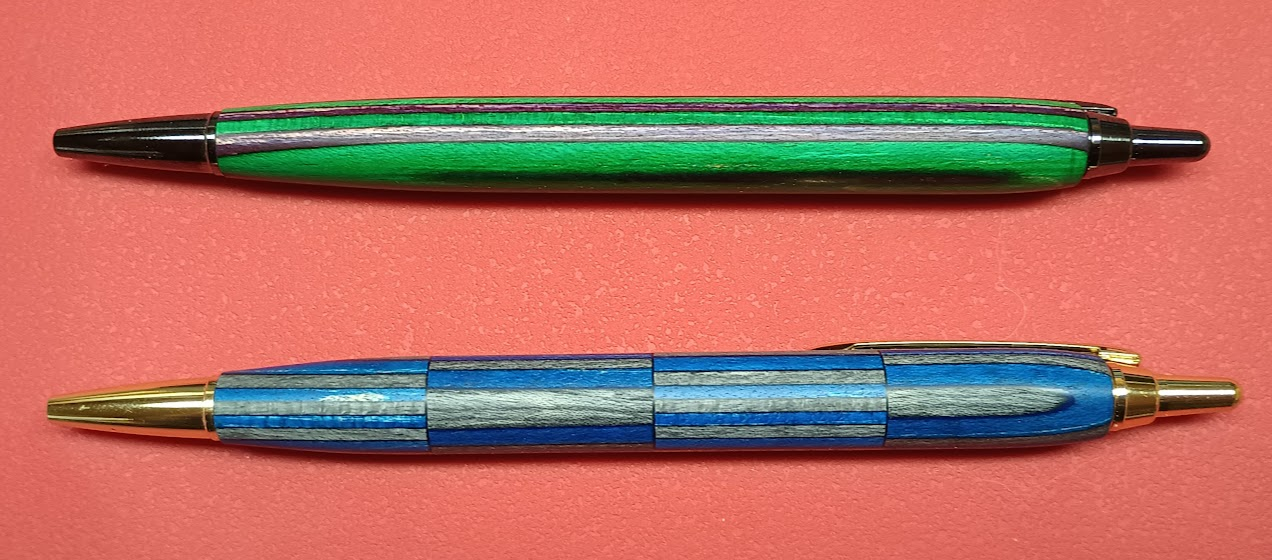

A couple of Grooves I did today.
Very interesting design. And those fine black lines ... very nice.
If you dont mind sharing, how did you eliminate he center band? How does the pen come apart for refills?
The new Groove kits have the clip end screw off. I put the two tubes together and turn down the center band to the 7mm to make one long tube.
