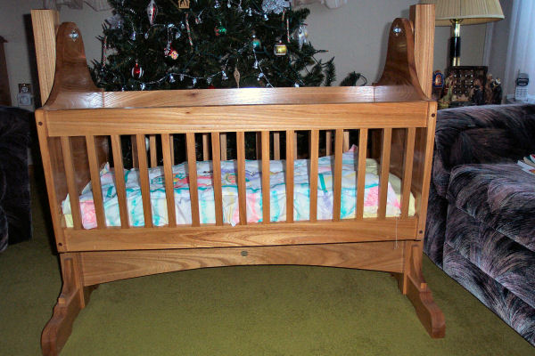

Congrats man.I have never built a crib so I cannot add any good info.Hope you come up with something good.Be sure to show us a pic of it.I would like to see it.
