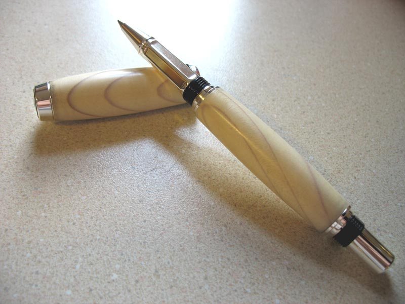

I've made quite a few pens from magnolia. It cuts well with a sharp skew, but can tend to tear out a little. I usually leave it a little proud of the bushings and CAREFULLY sand to final shape. I say carefully because I have had troubles with keeping black sanding dust from getting trapped in the grain of the wood. My best success has been to seal with thin CA right after you finish tooling, then between each grit of sand paper afterward until you get over 400 grit.
Here's a Baron I made from angle-cut southern magnolia:
