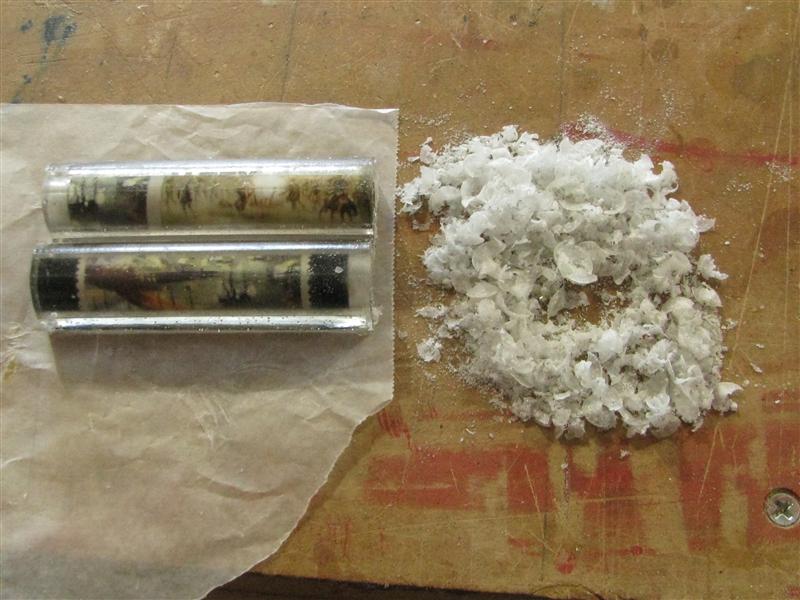

I have been casting alumilte for a few months. Wanted to try the ResinSaver molds, so I ordered one to have a go at it. The attached picture shows how much resin I had to drill out of the tubes. Good mold, just doesn't work very well with pressure casting, which I need to do to keep the bubbles out of the alumilite. I reduced the pressure from my normal 65psi to 25psi in anticipation of possible leakage, but it just wasn't enough to prevent it. Guess I need to look into using some PR ocasionally.

Alternately, fill the tube with plumber's putty, dental wax, or dowel.
Just push out the material with an appropriate size dowel when finished.

i found with mine if i use pressure i had to put pressure on the end of the mold pushing in on the tube with a small clamp . tape works by wrapping it around over the mold but is a wast of tape, clamp can be reused.
if you warm the resin and let it gas of before you mix, i don't have to use any pressure and get no bubbles
