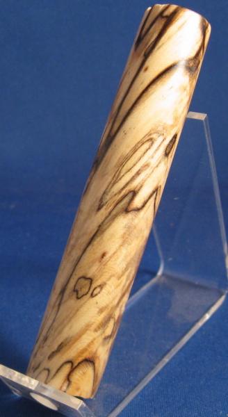

A friend sent me over some of this in boards and asked me to try and stabilize some of it for him. It sat there for almost 6 weeks soaking in the solution while my pump was down and after vacuuming it for another week, it is looking great. The stabilizer went completely through it and it is some real nice wood. As soon as the stuff stops stinking so bad, I'll ship it out to him. I used a lot of plexi and acetone on this and it really does stink.

I believe this stuff is spalted sugar maple. It is the first time that the plexi has worked for me, I guess the trick is to just leave it in there forever.
Neil, that is some nice looking wood, I have some nice looking but punky spalted maple, and some spalted Magnolia, perhaps I'll give the Plexi & Acetone a try.
