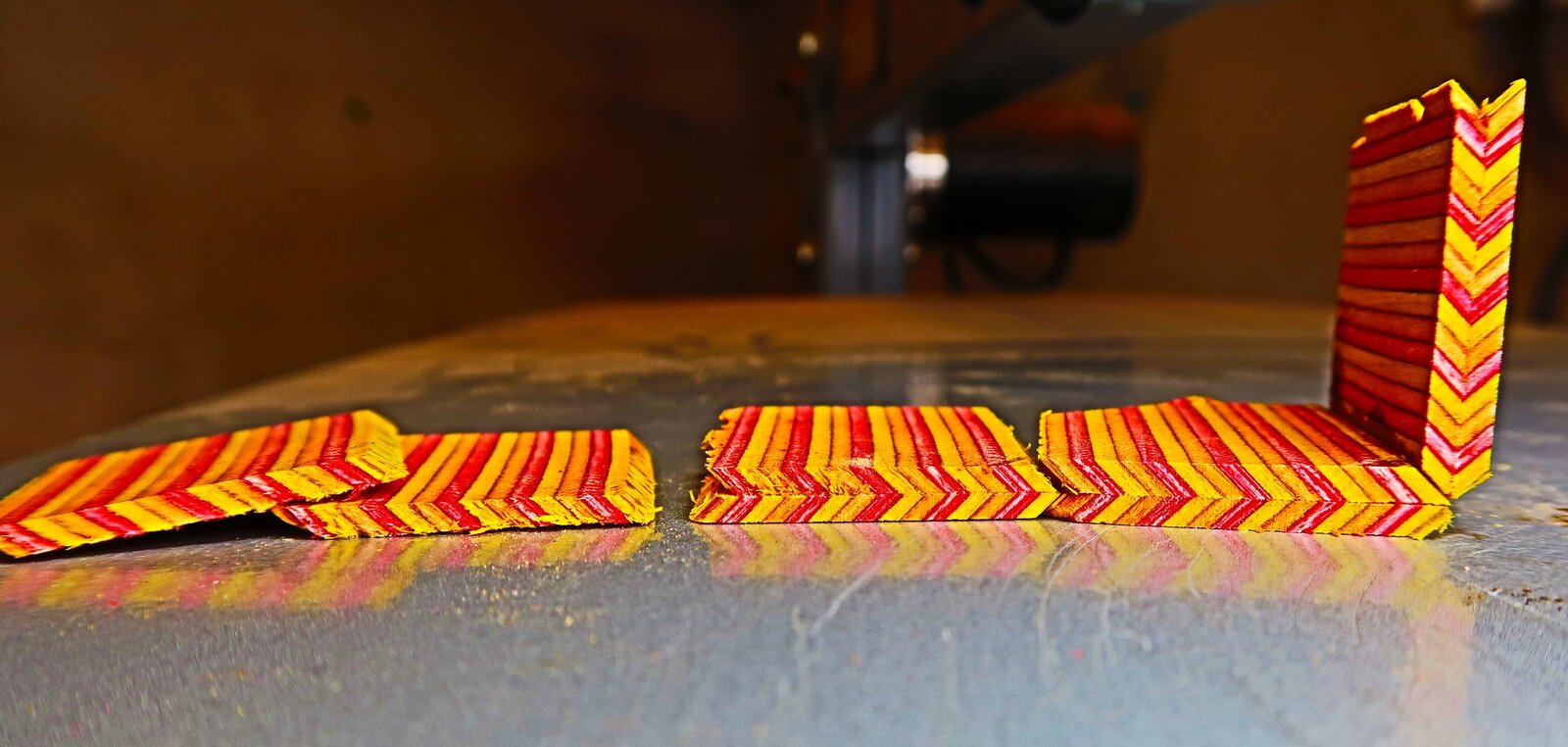

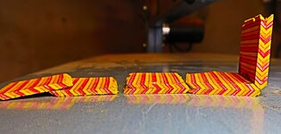

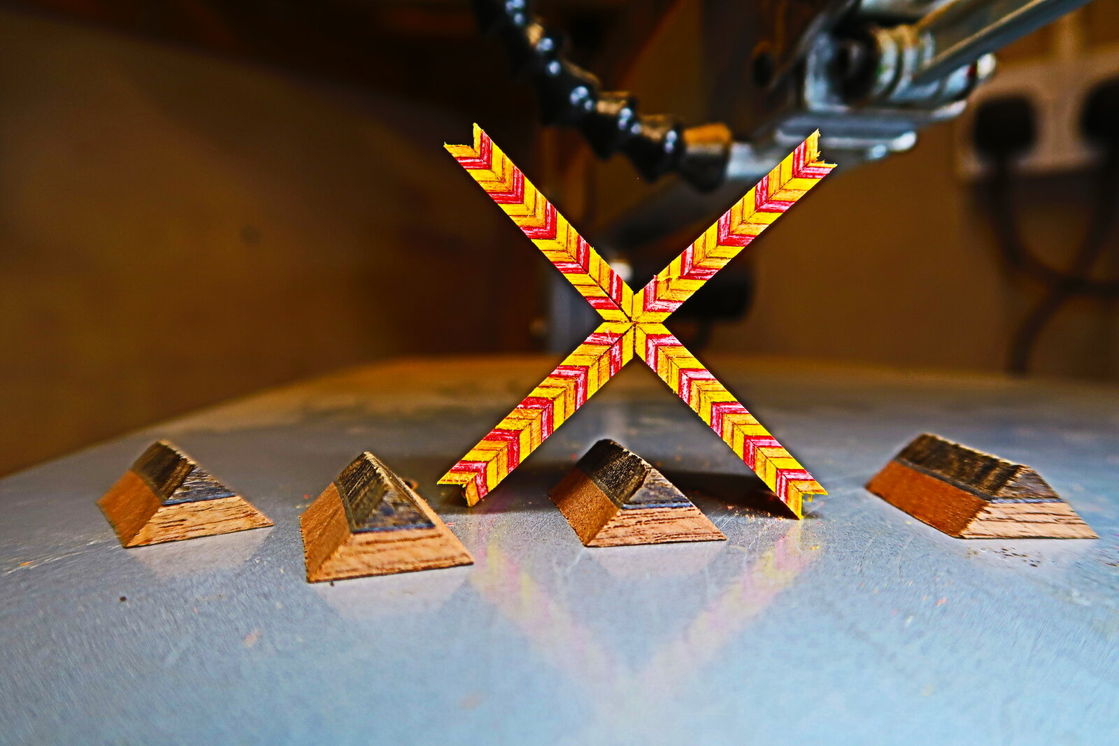

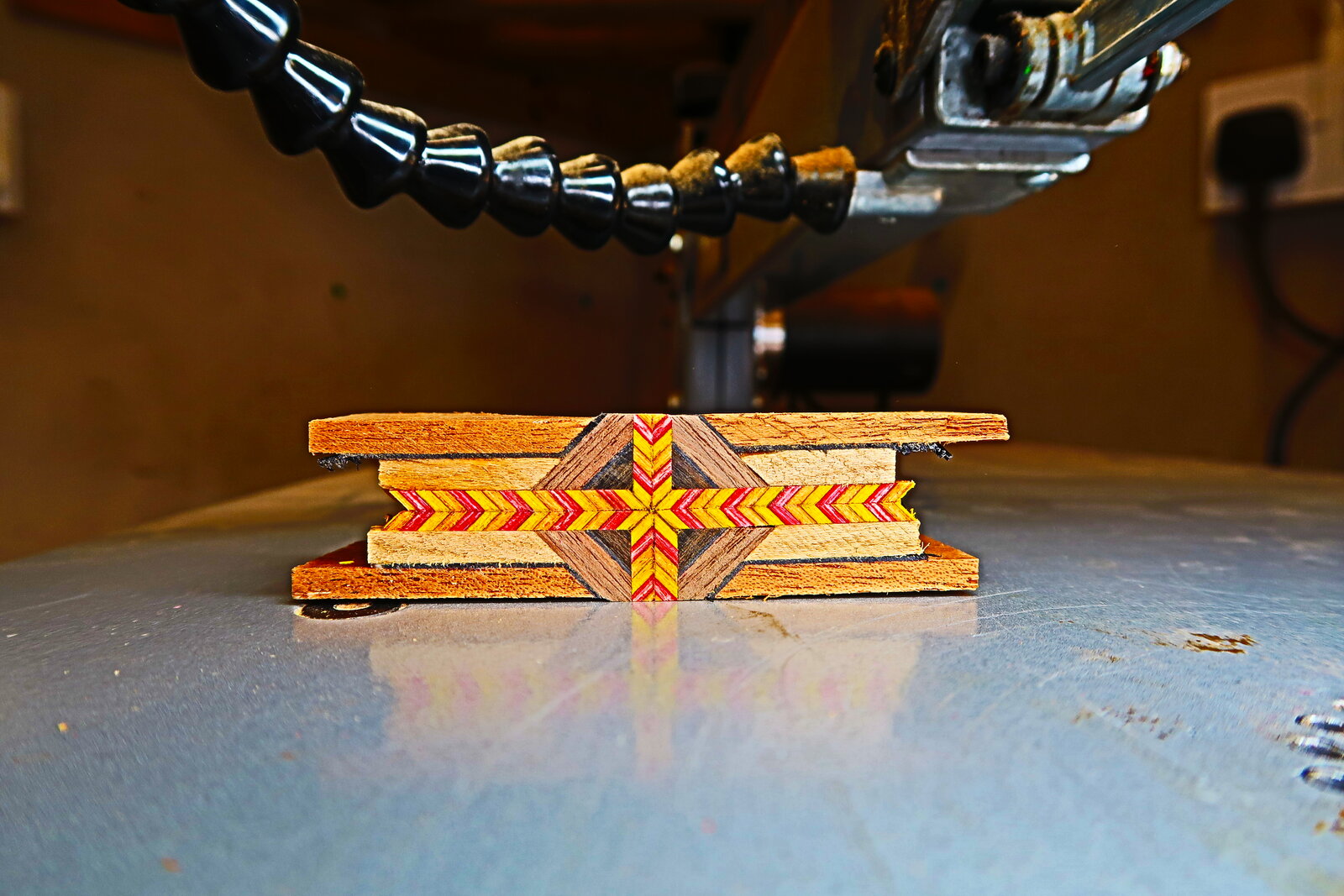

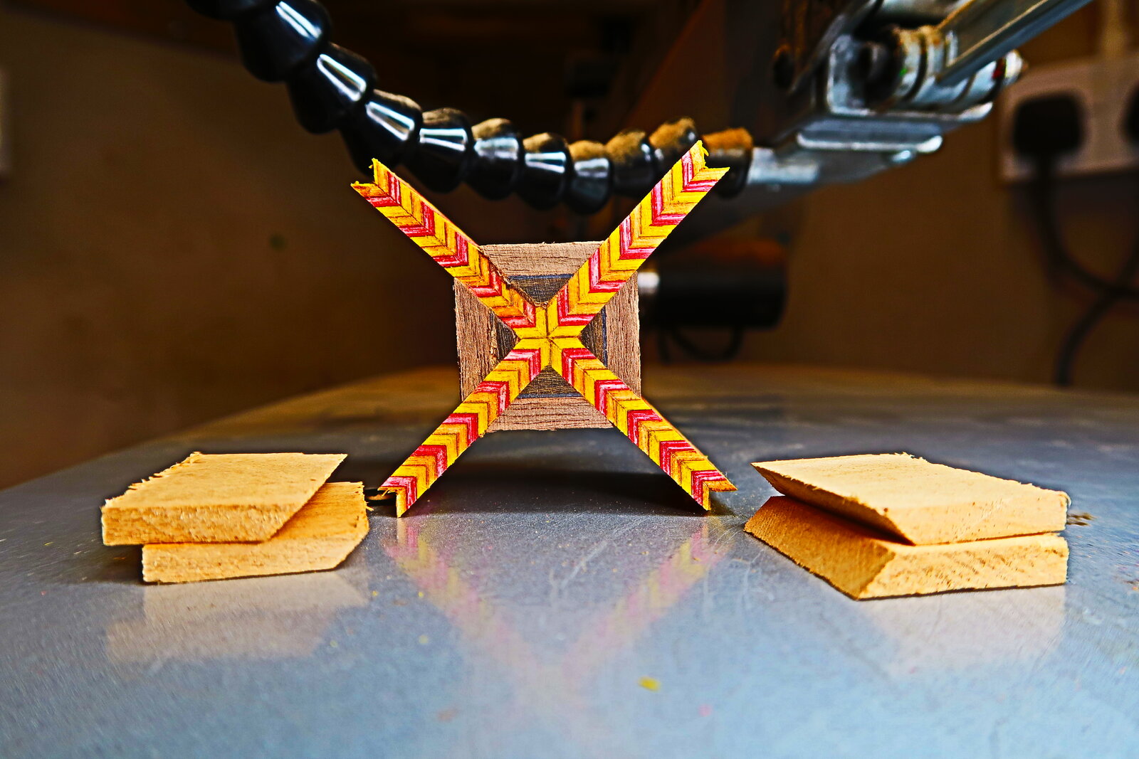

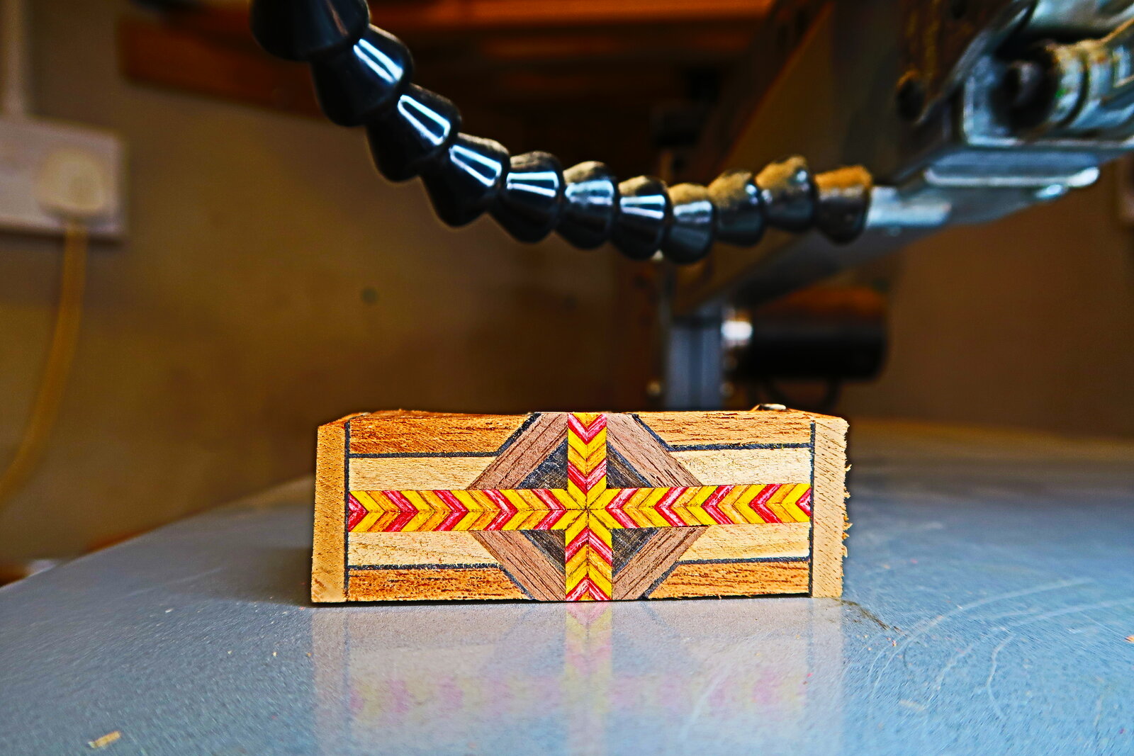

For those who are interested in segmenting here's some photographs of how I made a recent blank which includes Spectraply. IMG_0690.JPGIMG_0692.JPGIMG_0695.JPGIMG_0696.JPGIMG_0697.JPG

Thanks, John U. I put the photographs up to show how easy it really is. The most difficult part is glueing the spectraply cross. After that it nearly makes itself!

John, thanks for your comments. I have to confess that the blank looks more complicated than it really is.
The cross has to be glued with CA and that is the difficult bit, but once it is together and hopefully with 90 degree corners, then the other bits just fit in no problem. I then use carpenter's glue as I can then clamp.
I usually have a lot of pieces that are cut to 45 degrees at hand, so once the cross is set I pick out what I think matches, and that's all.

The spectraply is cut from a blank on the table saw with the guage set at 45 degrees. The slices hold together well, and even thinner than shown here.
I only had issues turning spectraply when I was turning the end grain. ( only happened when experimenting with a couple of blanks which were mainly end grain )
