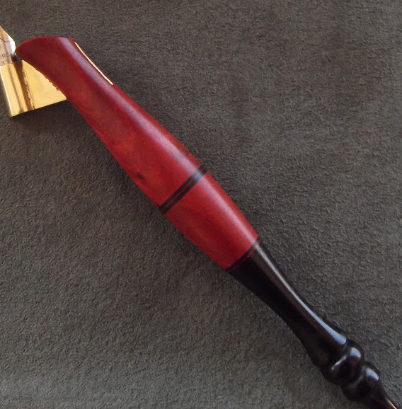

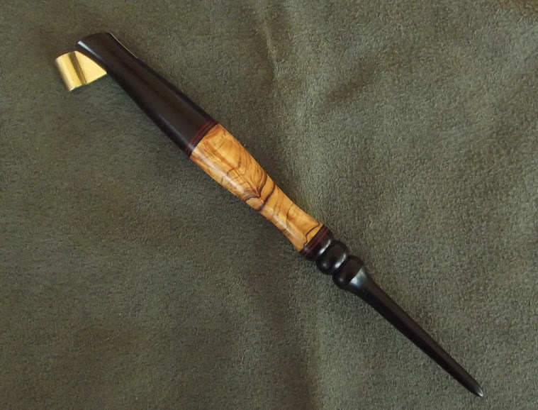

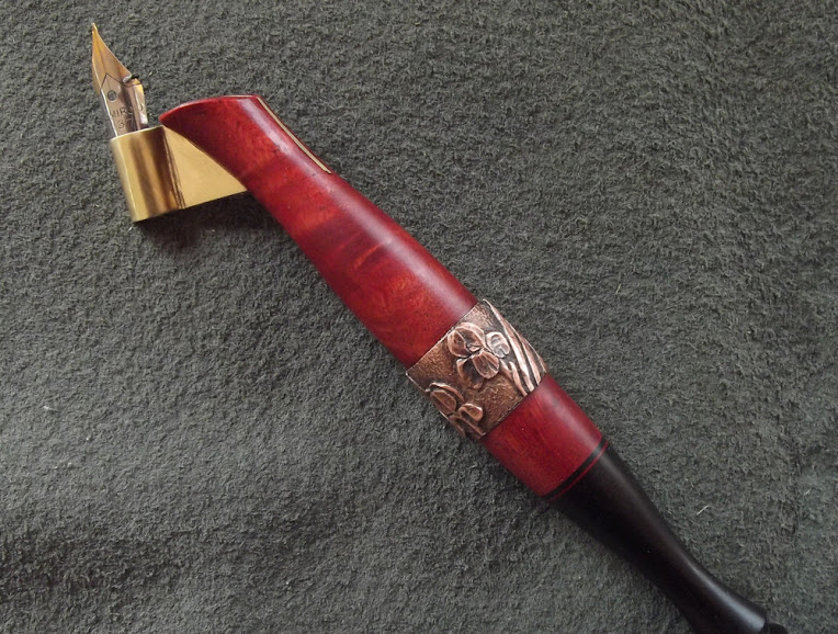

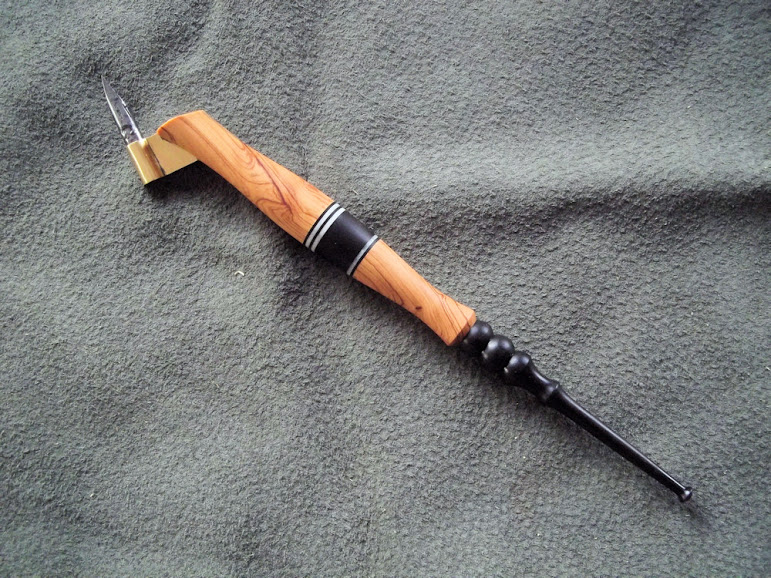

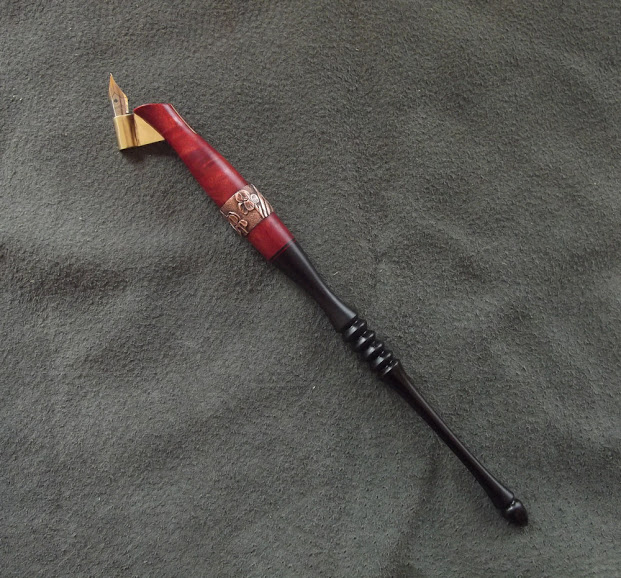

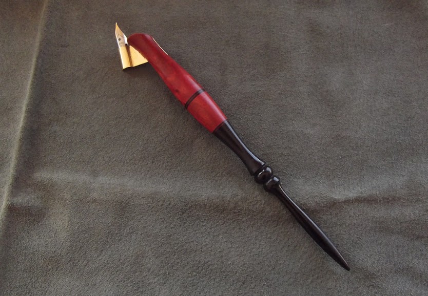

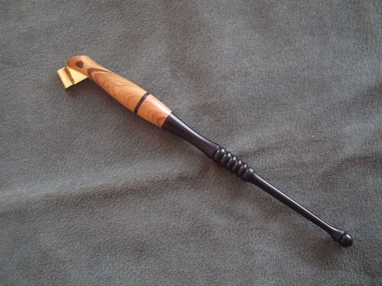

I am new to the forum and was asked on the intro thread to post more photos of my work, so here goes:
African blackwood and wild olive
African blackwood and eucalyptus burl
African blackwood, pink ivory and carved copper
African blackwood and pink ivory

Can you explain the reasoning for the design? Also, are these made by sections and then assembled or do you put all the woods together before turning?
I can see where things change material but I don't see any 'joints' persay.

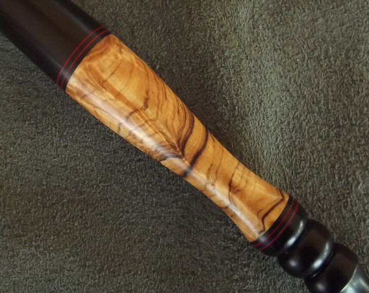

How did you get the very thin accent striping (looks red) on the African Blackwood and wild olive pen?

Stonepecker, I use two doweling methods:
Either a turned dowel on one end of a piece of wood, and a drilled hole to fit on the other piece, or two holes with some sort of doweling, usually some metal tubing. After a test fit to make sure I have all the bits in the the right order I use a slow cure epoxy; all the bits are stacked and clamped overnight.
ABinBoston, I use a resin impregnated fibre board, almost like thick paper.
These are sometimes used as isolating card inside electrical motors. Most motor rewinders use this type of card.
You can try one of the knifemaking suppliers such as Yantz, look for "fibre liner" or "handle liner".
Cut into squares and a hole drilled in the center, then rubbed on sandpaper to get rid of the burr raised by the drill. I have found that one needs to use a very stiff dowel when using a couple of the fibre "washers" to limit flex and tool chatter,
