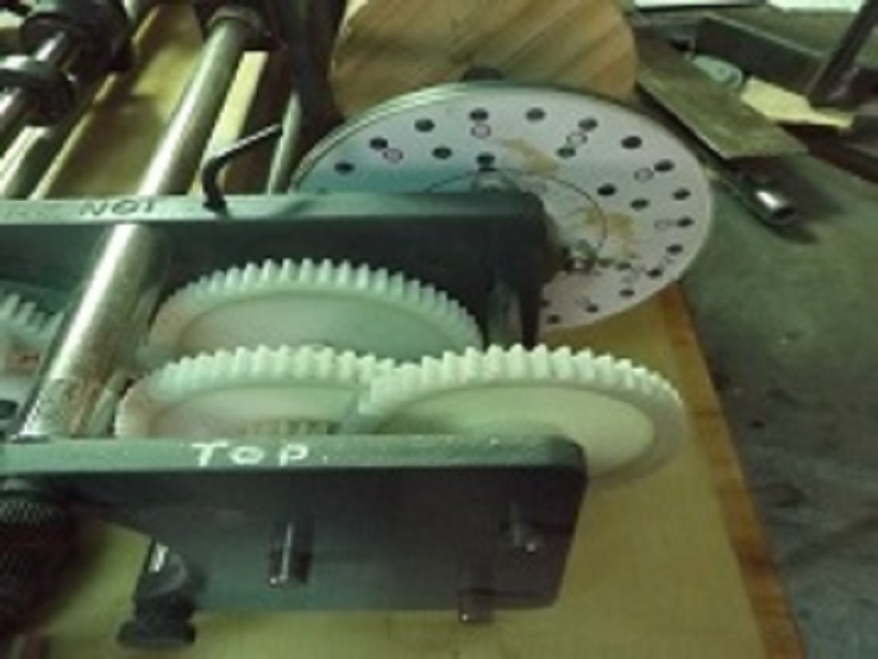

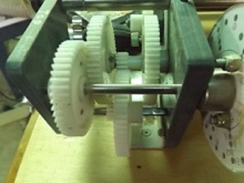

The gear arrangement on the top left side are 12 and 60 teeth gear joined together, drilled, fitted with a slimline tube to act as a bush
Placing the end plate round the wrong way, made me mark the top so that it went on the right way round, also note the holes drilled for the Allen keys

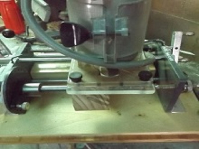

Set up with a Makita Laminate trimmer, I found the Dremel too small to do this job, unless I went over it 6 times, which took toooo long.

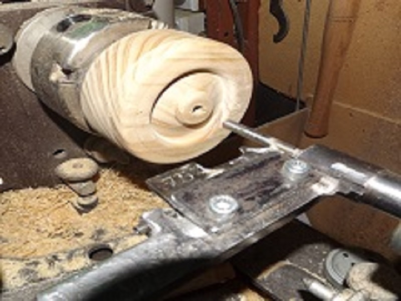

A close up of the tread cutting

Showing extra gearing
Extra 12 and 60 t on left top shaft

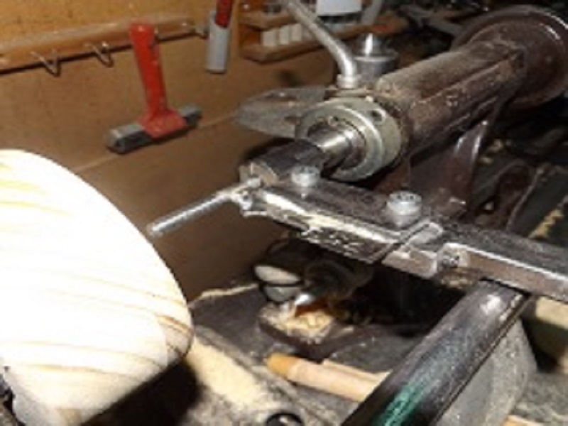

Laminate trimmer cutting tractor tread

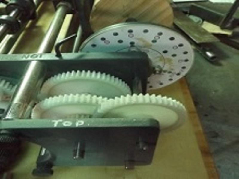

Showing wheel cutter
Close up of wheel cutter, this is my own invention, the cutting edge is replaceable, for different types of wheels, up to 31/2"

Will post more details of trimmer mounting blocks etc tomorrow. For details of Mods send me a PM and I'll put them here.

I like the wheel cutter, a friend made me one years ago to use on the drill press. Since then I have made a couple of my own. One of those I have to do this moments that worked out.
