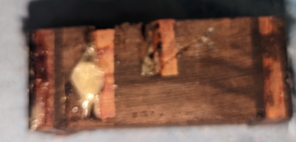

Just as an experiment on a 'learnin' pen'* I played around with Gorilla glue due to see if it will help with the number of blow outs I'm getting ala the Loctite GO2 failure thread, here's a couple of data points that i just found out
Gorilla glue foaming out through gaps in the segmenting. That was actually a pretty snug fit for the segmenting too, needing a few seconds on the belt sander to thin the segment down enough to just fit. This was with the end clamped closed to keep the tube from potentially being pushed out. That expanding foam had to go somewhere.
But the CA that glued the segment in held it in place.

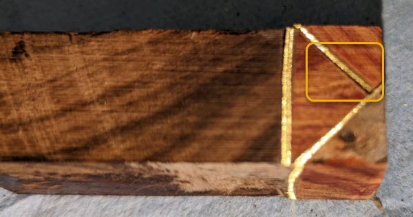

The shine line dampens the impact, but there is a very visual hiccup at that point in the pen. The same issue can be seen at the other side of the segment.

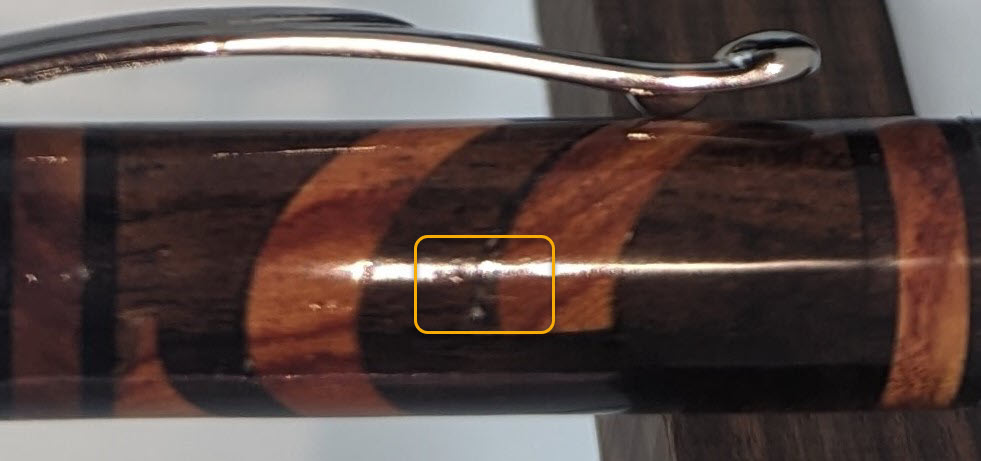

On the scallops side the gorilla glue got in there and pressed open the segment. Segment was glued down with epoxy (either Mercury or T88, I can't remember which line of effort this happened on). I was able to get in there in time and clamp down the segment before the glue set.
For me I think I'm going to avoid Gorilla glue etc for any segmented pens I'm working on. That being said, the foaming/expanding aspect appeals to me on non segmented pens as I too tend to see large 'dry' spots where there is no glue on those times when I have a blank blow out.

Very interesting. My experience with using polyurethane to glue in tubes has all been positive, but I don't do a lot of segmenting.
One could arrive at the conclusion that this experience demonstrates that polyurethane should not be used to glue tubes in segmented blanks. In my mind, that generalization is entirely too broad.
Or, one could conclude that the segmenting glue-up needs to be done better if polyurethane is to be used to glue in the tube. Perhaps that's a good thing - if you see foaming between segments when you glue in the tube, you should revisit the process used to glue up the segmented blank to prevent that problem in the future.
Or, one could conclude that the use of polyurethane glue when inserting the tube is a quality check on the segmenting - foam between segments indicates that the segmenting glue-up was defective, and the blank should not be used. Again, probably a bit harsh, but it really depends on how severe the foaming is and the impact of the finished blank.
I'm somewhere between the second two interpretations. But I will note that it would be incorrect to assume that using polyurethane glue on the tube compensates for sloppy segment glue-ups because the foam will penetrate any gaps between segments - yes, the foam will penetrate gaps if they are present, but that foam has little or no structural strength. It may fill the gaps cosmetically, but it doesn't strengthen gaps that are weak.

To me, any gap in a segment in which tube-blank glue-in can escape - the builder needs to revisit his techniques and gain more experience. For any gap that can be seen by the naked eye or for glue to escape - more practice is needed.
Unwanted holes and spaces in segments are learning moments or events.

Now I don't have a dog in this fight and there is _no_ doubt about needing more skill here. Like I said this was a learning pen - I mostly wanted to see what I can do with scallops and start getting familiar with my new Byrnes.
(BTW the final pen is uuuugly but the ones that come after it will appreciate it's noble sacrifice to the cause.)
I can see that the problem with the lower segment on pics 1 & 2 is structural as the dimple or mar is on both sides at the same edge. As I said, I had to sand them down to get them to fit into the cut and I would guess that segment was sanded at a very slight angle. The flaw is however only around 1/32nd of an inch / sub 1 millimeter in size. There are similar flaws with the upper and middle segments that are even smaller than that.
As for the 3rd pic where the glue was pushing open the scallop - I'm showing that simply to show that there is indeed outward pressure. Now if that pressure could have been mitigated by giving the epoxy more time to cure (I may have to give it 48 hours because 20-24 wasn't cutting it) and/or brass that thick is just a general pita to work with at that angle.
I can and will be looking at ways to get a more even sanding as well as adjusting my curing times (and about 10 other improvements - like I said... this pen is uuuuuugly) but for _me_ the chance that an unseen flaw of that size can end up ruining the final product just isn't worth the risk.
On this we certainly agree. And, from my so far singular experiment, those weak gaps let the glue come up to the surface and left a problem with the end result - finish was 3 coats of thin CA and 4-5 coats of medium and there is still a feelable divot at the weak spots mentioned above.
