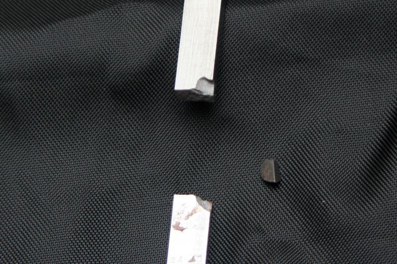

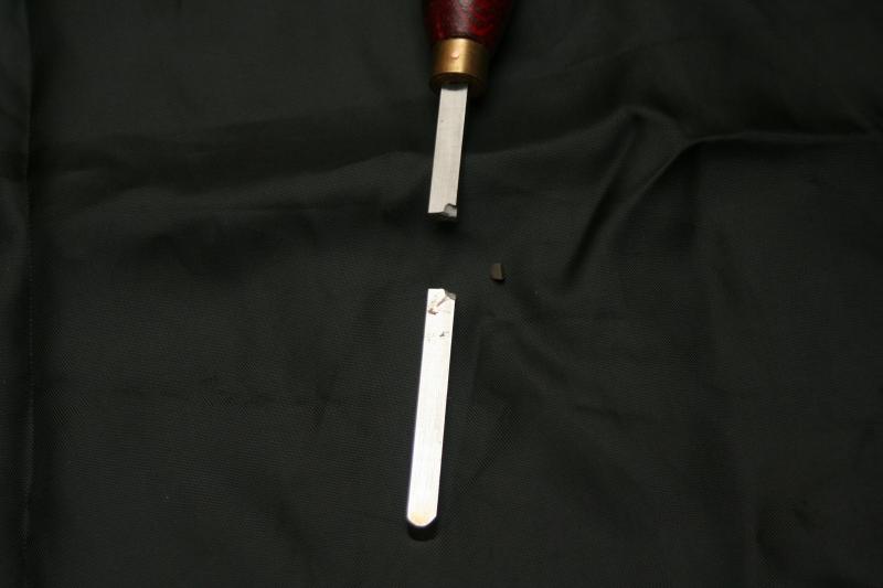

Turning a bowl for the first time, doing it out of walnut. I used my little round nose scraper to clean up and smooth out a high spot inside the bowl. Something caught on me, bounced the tool off the right then snagged the outside edge of the bowl tearing a chunk out of it as I hear a loud metallic snap and saw the broken piece fly up in front of my face and onto a shelf. Good times.

Wow!! that was some catch! now I know why I only do pens :( To break tool steel like that is no mean feat indeed, As a fitter at times I have had to break tool steel to a workable size (before friction cutters) by grinding on the corner of a wheel then holding in a metal vice and hitting with a hammer ,still hard to break at times, you must of had a mighty good grip of the thing not to have the whole thing fly out of your hands ,glad you are ok though if at least a little shaken up . cheers ~ John

You were over hanging the tool rest way too far . Turning tools are not meant to be used without support close to the work surface . Tool rests HAVE to be kept tight to the work piece .

Holy crap! I tend to agree with others- your tool rest wasn't set properly. Just be glad you didn't get a finger/ hand caught in between!

Thanks everyone. Was wearing a face shield fortunately although it never hit it. It just flew up in front of my face and landed little ways off. I didn't think this size of tool should be an issue with what I was working on. I do agree that I possibly was to far away with the tool rest. I did get it as close as I could but must not have been enough. I might have to invest in a S-tool rest if I want to do more bowls.

2nd ... Is it just the lighting or what? The small chip you have in the posting appears to have rust or something like it on the fractured portion. IF that is the case then I sure as hell would return it - and all the pieces - to the place where you got it and point out that the metal WAS cracked. IF they do not want to help you with a replacement find out who their vendor is and contact them immediately.
IF it is not rust then chalk it up to experience, get a new tool, get a curved tool rest, and move on. This time keep adjusting the tool rest so that it supports the tool ... just remember TO TURN OFF THE LATHE when adjusting anything other than the speed control.

Me too, I am glad you weren't hurt, I've seen that happen to some P&N scrapers, occasionally they get them a little bit too hard and don't get the temper quite right, so the tool is a bit brittle. some of the worst are some of the tools from HF they either are too soft or too hard, but they are catching up in technology. Kryo hardening is good if done right, with the right metal.
