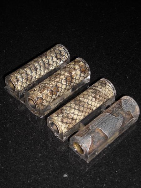

Just thought I'd let you see my first attempt at the snakeskin casting. I got the copperhead from my buddy, and made sure it was nice and clean with some denatured alcohol before gluing to the tube. I also let it and the Prairie RS set for a few days to make sure no moisture and/or gases from the CA were present. The only handy paint I had was flat black, but I'm going to try the copperhead again this weekend with a khaki camo paint I picked up yesterday. I think that will really make those colors pop!
Just wanted to say "Thanks" for sharing your knowledge on this. I'm hooked!
Dale

Dale,
You are welcome. I'm glad your blanks came out. They look very nice. Be sure to show the pens whrn they are completed.

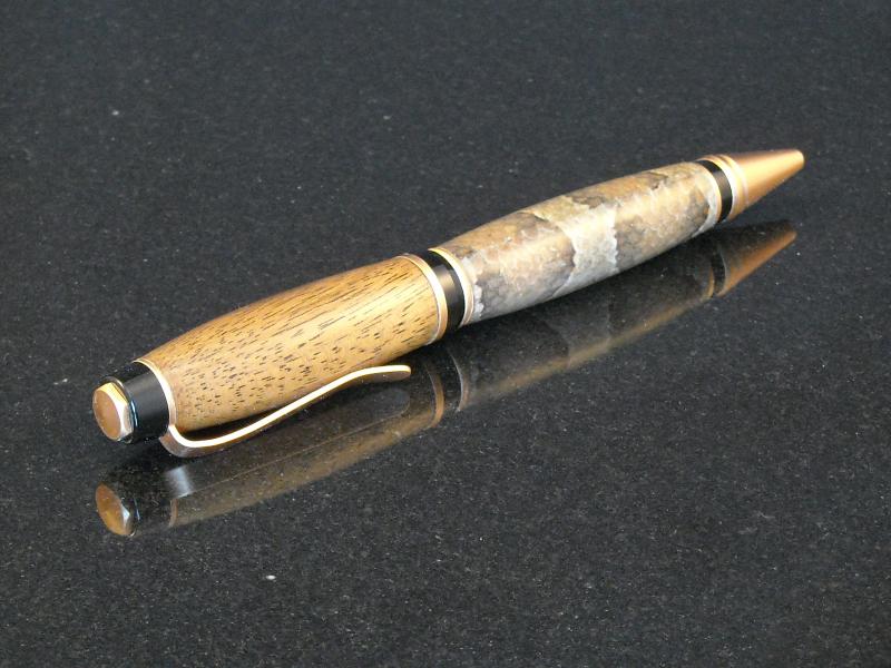

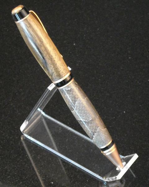

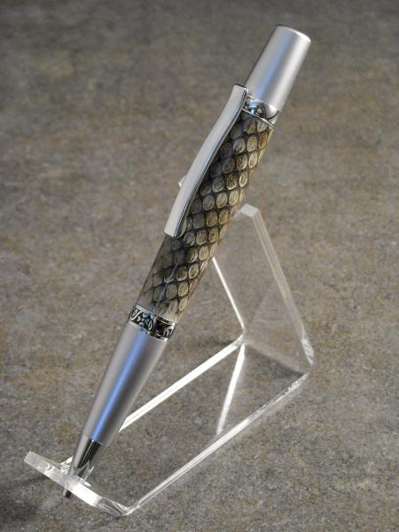

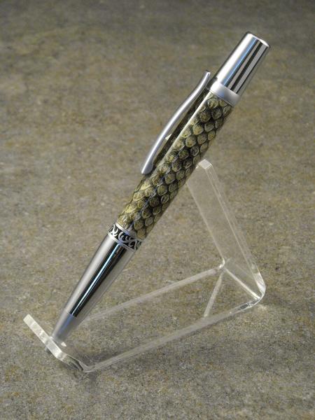

Well here are the results of my first "snake charming". Probably not a great job, but I'm pleased for it being a virgin run. I do know that once I face/square the blanks, I'm going to drizzle thin CA around the edge of the tube to keep the PR dust from migrating underneath. Also, the copperhead blank that I had casted for the Sierra blew apart, so I cast one for the bottom of the cigar pen and matched it with some nice native Texas mesquite and satin copper (head) hardware...it's all Texas! Let me know what your thoughts/comments/critique are.

Well Dale....you are hooked. It is fun, isn't it? Your pens look really nice from what I can see. I never know what wood to use when doing half skin half wood but you seem to have made a match with the copperhead and mesquite. Keep up the good work and I hope the snake skin casting demons don't find your shop.
