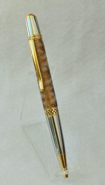

I agree with Seamus7227. I have cast a lot of the bigger snakes. Rattlers, cobras, pythons, and even an anaconda. See my photos for examples. First one is a large Indian Cobra, second is an Anaconda. The bigger the snake, the harder it is to get something that you can fit onto a pen and recognize what type of snake it was. Smaller or more colorful skins are a better way to go. The under side or belly skin used crossways makes an interesting pen, but as with the larger snakes, you have to tell the people what they are, or they have no clue. When you take any snake over 5 feet and put a piece of it on a 2 1/2 inch pen blank, there is something lost in the transition. I have several Cobra skins with the heads on, and I have been trying to figure out a project and a way to use the open hoods. Maybe a pen box top for a Cobra skin pen??? Jim S

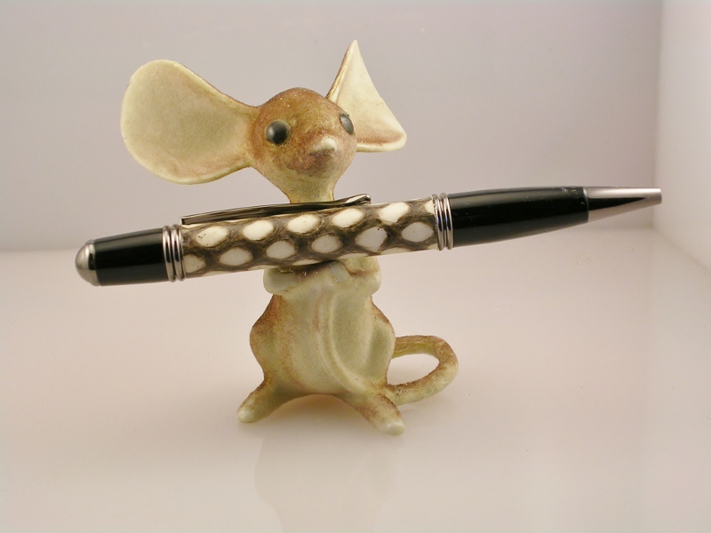

This is the belly area from a Western Diamondback. Not sure IF you can see the larger scales. Be well............Jan
