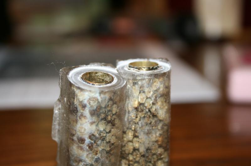

One , Polyester resin blanks have a sticky surface to them as part of the design of the resin . This allows any further pours of resin to stick to the surface better then fully cured resin . This sticky surface can be avoided by either post curing the blanks for an hour or more in a low temperature oven at the expense of creating a more brittle blank , or adding a surfacing agent (styrene/wax mixture) . The sticky surface has no negative effect on the blanks other then being sticky .
Two , Tubes pushing out . The cast object (snake skin) has to be stuck to the tube by some method . This means it must be glued to the tube by some method . most glues are softened by heat and in casting there is heat created by the curing of the resin and post curing (if done) . This heat can break the glue bond to the tube causing the tube to break loose . While annoying this can be easily repaired by simply putting a couple of drops of thin CA on the ends of the blank and allowing it to soak in . Also using a barrel trimmer can cause enough heat by friction to break the glue bond to the tube causing the same problem . I always advise using a sanding of the ends rather then barrel trimmers on any cast embedding blanks to avoid the heat problems .

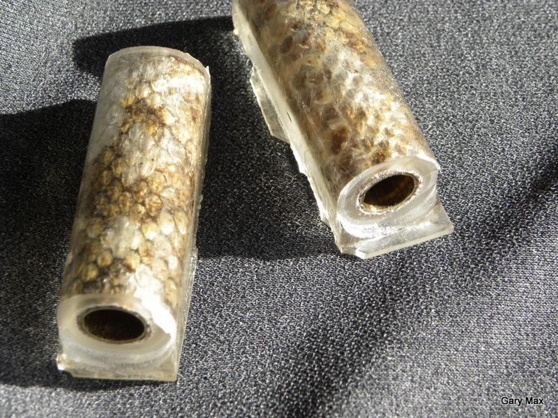

5th----Here are the blanks that you returned to me----the two Rattle Snakes where never even mounted on a lathe---instead you screwed them up trying to square the ends and you removed to much material---now the blanks are to short
Second---the Python----you turned it and hit the skin----one drop of CA and it would of been fixed.

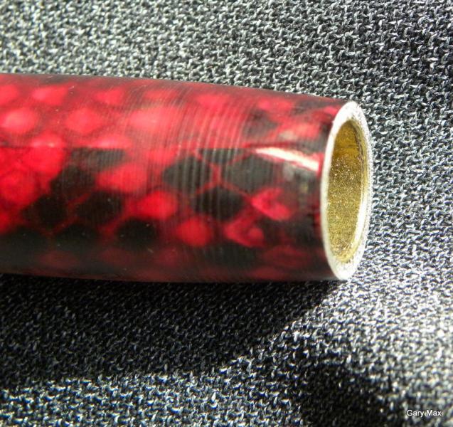

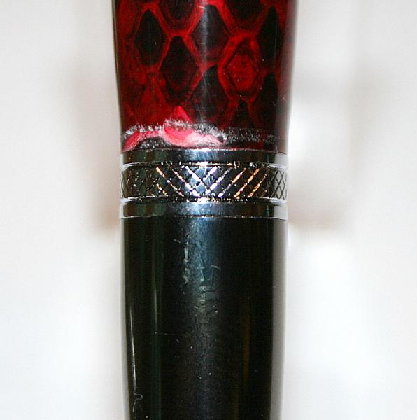

Looking at the pics of this that are posted, two things look to have happened
The top pic, looking at the insides of the tubes from the way the pic is, there was either residue on the tubes insides, or on the pen mills used to mill the ends. This caused heat to occur and caused the tubes to unbond.
The bottom most pic (the red blank), it is fairly obvious when looked at it full sized, the the person who worked on this blank was using a scraping technique, and had the scraper (or skew on its side) in a positive rake as evidenced by the chatter marks that are visible going up to the chipped out area. Yes, the blank looks thin, but with proper technique, there was no reason that on chipped out as evidenced by the pics provided.
Sorry, but the original pics would lead many to believe that the errors are on the side of the turner.
