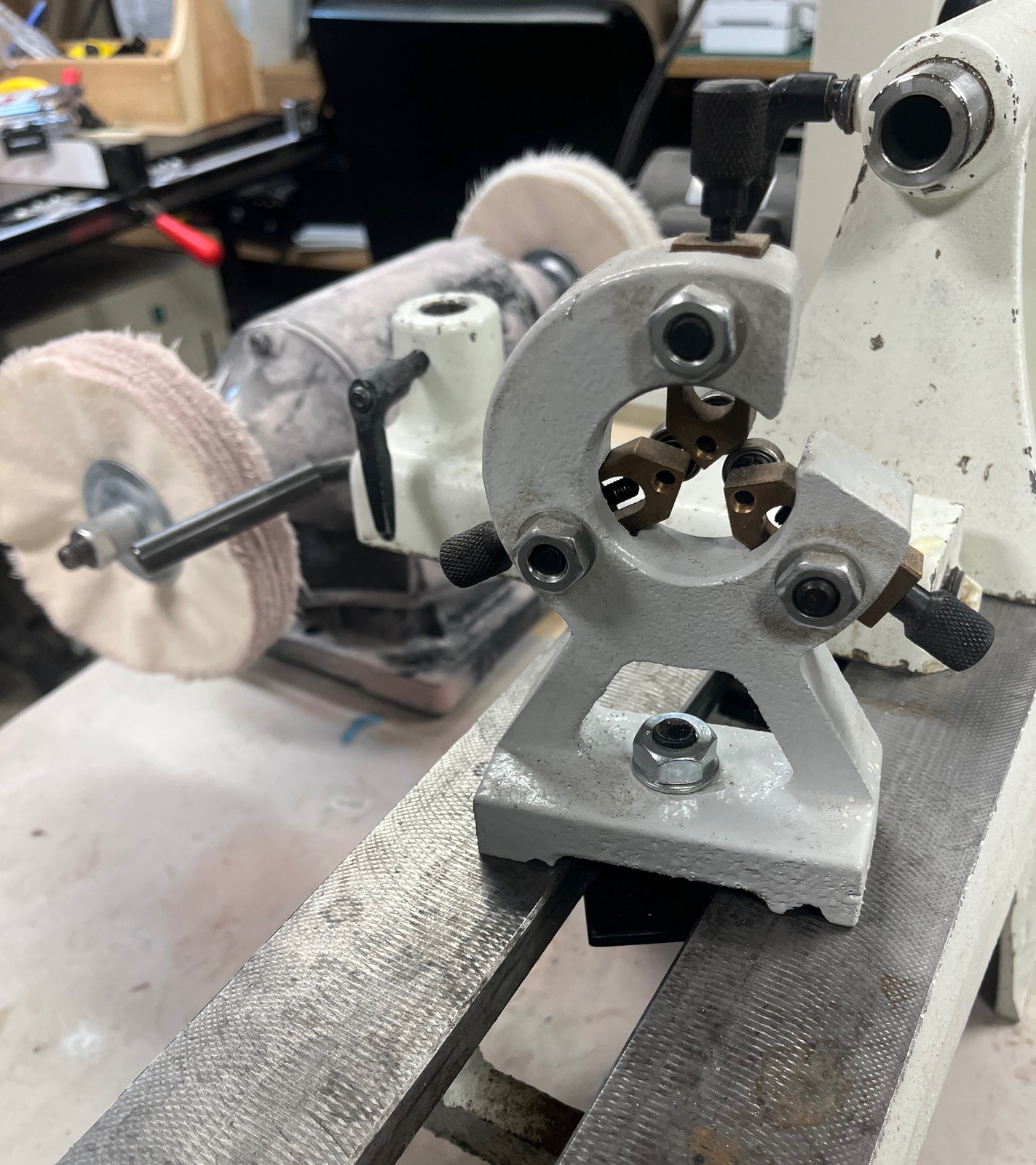

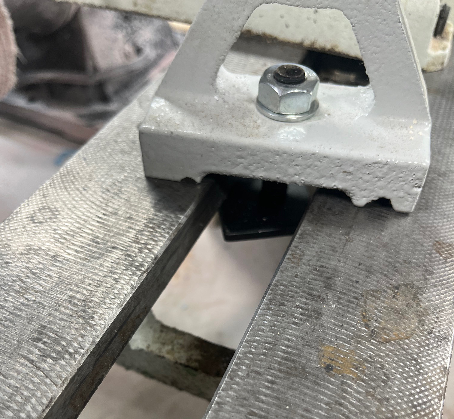

I just tried one from my metal lathe on my JET, and it kind of fits on my Jet lathe. They have a banjo base that can be tightened to the ways. It doesn't fit flush on the ways, but you can clamp down the steady rest. The opening in my ways is 1.25 inches. It does not sit aligned with the spindle height, so the steady rest would need to be heightened with a block below to be usable with the Jet.

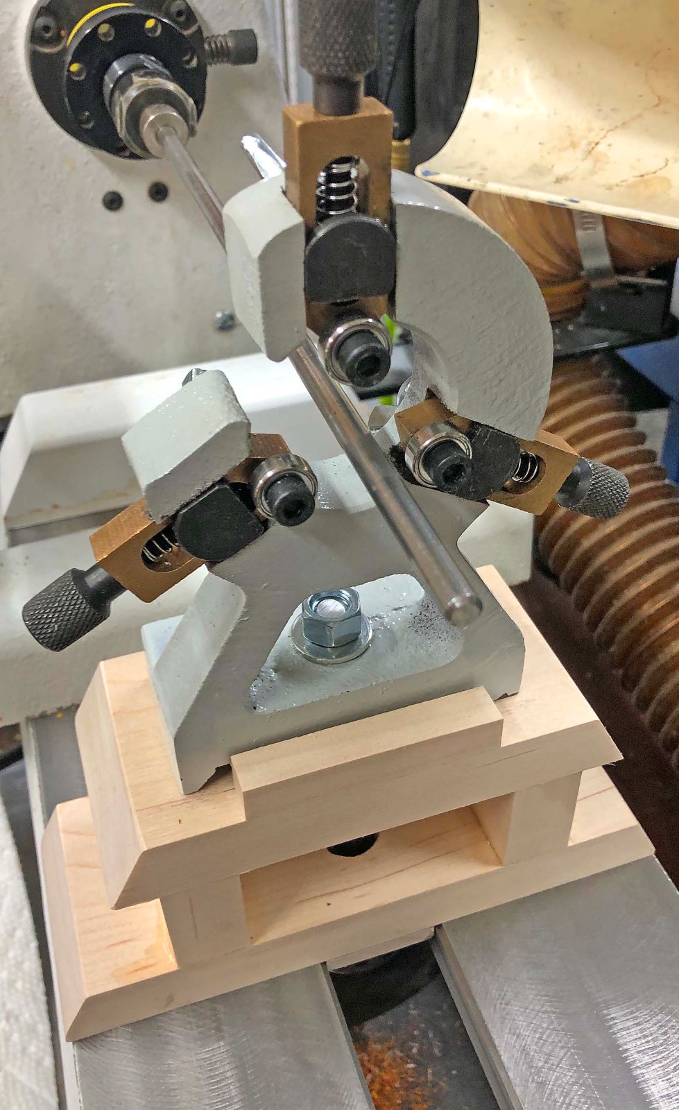

This looks very encouraging. I am going to buy one of these from Little Machine Shop and then design and test a wooden adapter plate to fit my JET ways and to raise the Steady Rest to the right height. Then I will ask Rick Herrell to see if he can use my model to design and build something functionality similar out of steel for me.
