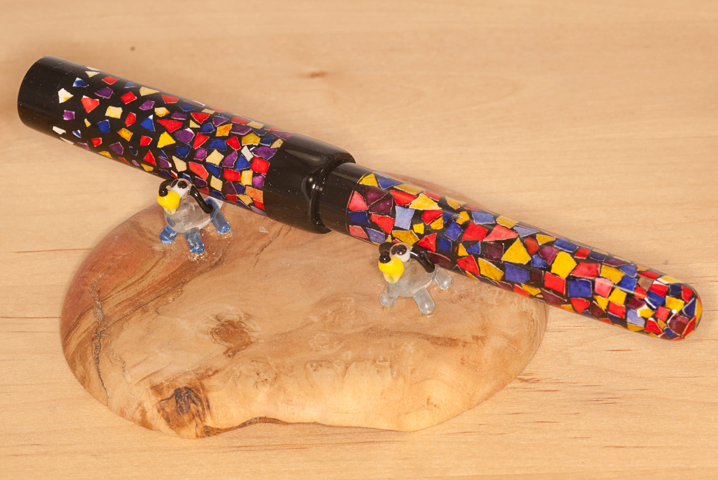

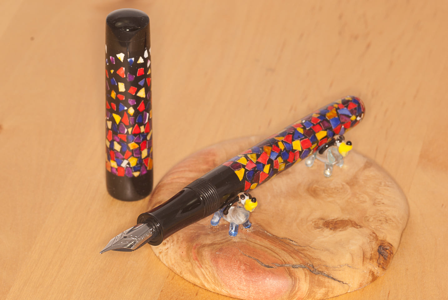

I made this one by making a barrel and cap from black ebonite (hard rubber), then used uv-cure resin as both a glue and covering for the coloured chips of egg shell. I built up a single thick layer in small patches which I cured before moving on to glue-and-cover the next patch. Then I turned it and sanded/polished as I normally would treat any other resin pen. It's been a couple of years, so far no sign of scratching - but I expect there's some variation between manufacturers.
Speaking of rainbow-tailed unicorns ... :cool:
View attachment 376912View attachment 376913
I love this pen! And this is exactly the process I was curious about experimenting with myself. Thank you for posting the pics and sharing your process. How did you colour your egg shell? I like that the color isn't totally uniform on the pieces but has some variety in shading.
Thanks! It was something I tried as an alternative to casting, which would have required a pressure pot (that I didn't have at the time) and would be a bit more complex getting the entire surface glued on before there was anything protecting the shells on the underside.
I'm trying to remember the sequence I used - I think I broke it into the small chips then coloured them.
First step was to peel away the interior skin, then break the shell up. I arranged the chips on waxed paper into groups of however many different inks I'd decided to use. (I got pack of 12 "Limino" brand alcohol based inks from Amazon, cheapest I could find.) I used an artist's paintbrush and just splotched it on - the shading is because I didn't make any effort to brush out the ink to a uniform layer. Alcohol ink dries fairly quickly. I used a toothpick to hold down the tiny bits of eggshell and keep them from sticking to the wet brush.
